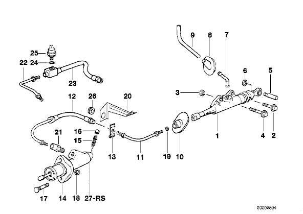

          here it is, a schematic of the clutch control parts:
          when i first thought the noise was from the tranny, i had put it up on stands to try and source the problem. old man got under there and said that the bolts for number 14 were loose. esp the bottom one and everytime i pressed the clutch it would push out a bit.
          they were tightened down, but the noise hasnt really gone away. what would be the symptoms of the input shaft bearing?
