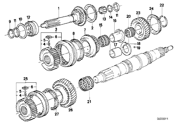

the pressure plate was fine so that wasnt the case. with the tranny off, i spun the shaft by hand (in neutral, 1,2 and 3) and could feel the knock, and did not spin as easy as my newer tranny. there were no leaks
it felt the same as turning a bad wheel bearing. im no expert on rebuilding trannys but for MY tranny's situation im guessing it would be #12 listed in this realoem pic.sigpicComment
