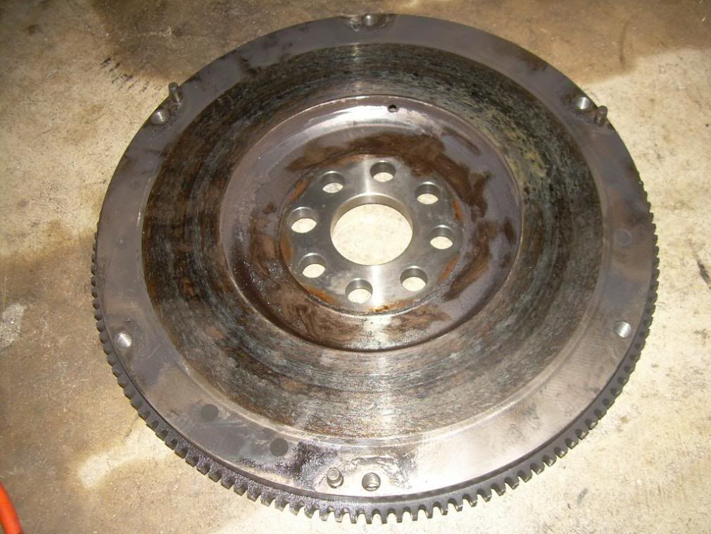

    5) How can I tell if the flywheel needs to be resurfaced?

      The flywheel needs to be resurfaced in the least, balancing and lightening dont cost much more.

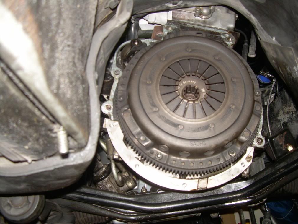

          Well, I got the clutch in and everything is gravy. It wasn't that hard of a job. Not nearly as terrifying as I had been led to believe. I'll answer my own questions:
          1) I got the 30mm deep socket at PepBoys, then held it to a cinder block with a C-clamp and used an angle grinder to grind the outsides down to size.
          2) I went to sears and bought a single 20" 3/8" extension and one swivel joint. With the tranny dropped down that was long enough to reach those back bolts. I also bought a four piece adapter kit (1/4"to3/8", 1/2"to3/8", ect...) that came in handy.
          3) Flywheel bolts are "stretch to yield" bolts, and are only supposed to be used once. I didn't realize this until I was putting everything back together, and mine is fine.
          4) You don't need to remove the intake manifold to get to the starter bolts, just the intake boot.
          5) Look for scoring/warping. Mine looked OK and I was on a super-rush deadline, so I just cleaned it with some brake cleaner (use nothing else) and that's it.
          The bolts in the back were tough to reach, but not impossible. I didn't have any problems.
          It would be very helpful to have another person with you when you're doing the starter bolts and putting the tranny back in.

          • PiercedE30
            • Apr 2005
            • 4220
            Nice. How do you like the Spec ST. 3? I'm loving mine.

                  • Jordan325iC
                    • Aug 2005
                    • 1697
                    I love it. Feels like stock but holds my current 280ft/lbs with ease. It takes just a little more finesse to get smooth starts, but it's not uncivilized. No drivability problems.
