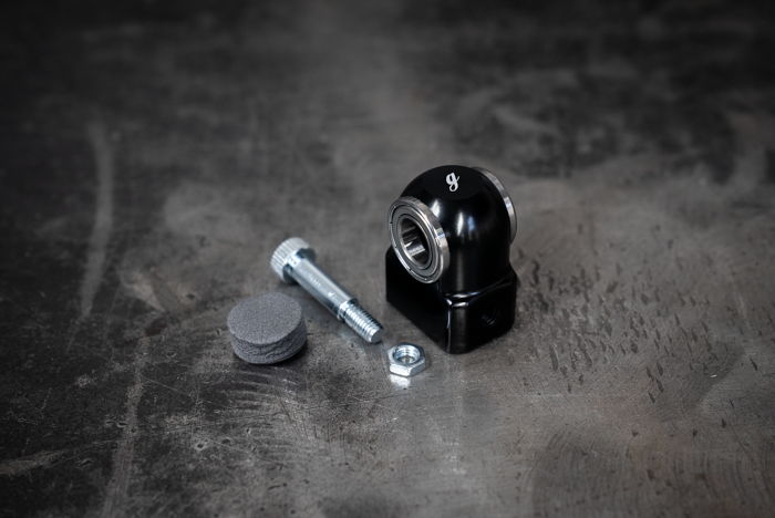

                      I purchased the DSSR and selector rod joint from Garagistic.
                      BMW E30 187MM DSSR - 25111220838 Introducing the Garagistic E30 187mm DSSR for your 1984-1991 325i or 325is (not for 325/325e/325iX, 318 models but those are coming soon). To start off, what is a DSSR you ask? Well it stands for double shear selector rod, it's a selector rod that will spread the torsional force on both

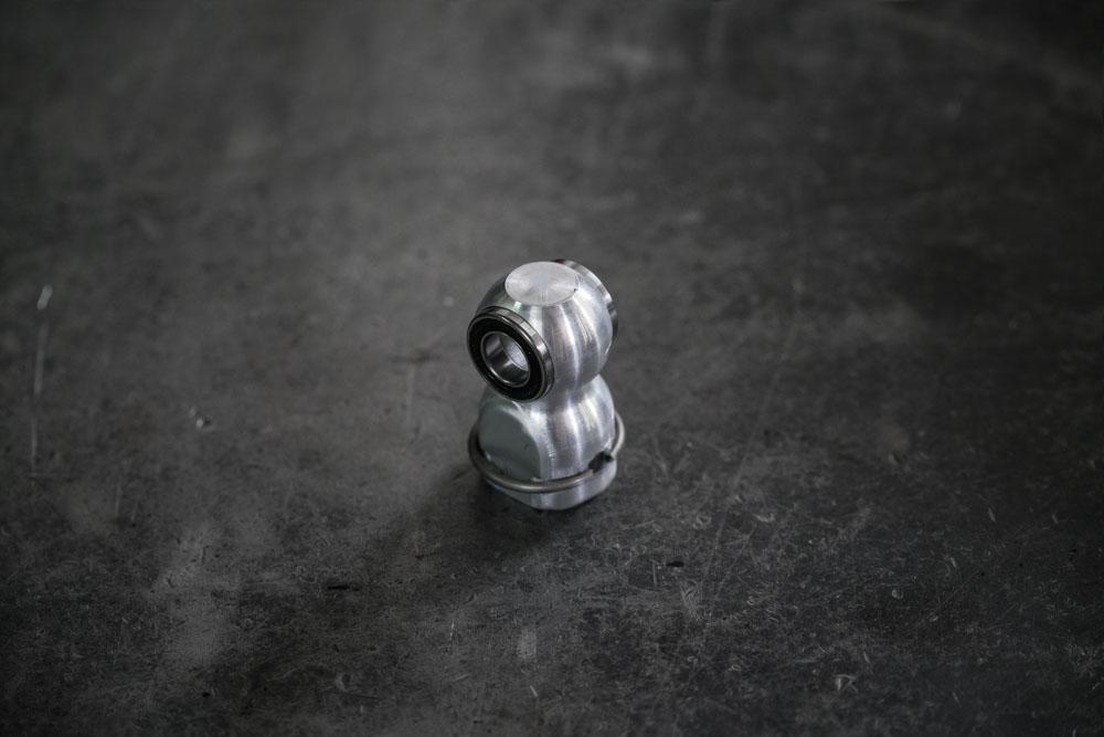

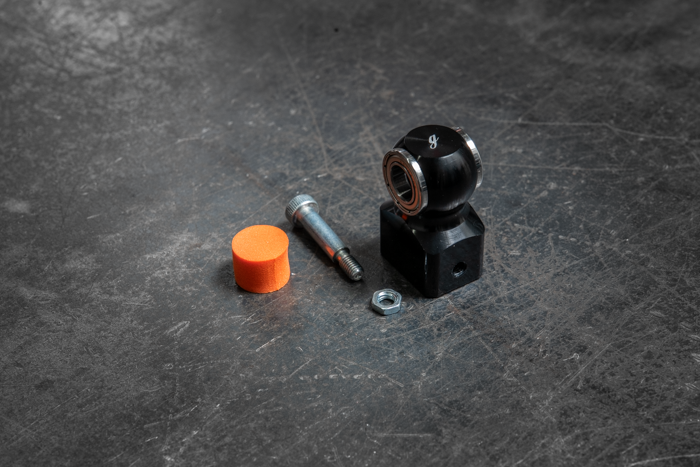

                      GARAGISTIC STANDARD SHIFT SELECTOR JOINT Overview One of the most noticeable easy changes you can make to get rid of your BMW’s shifter slop is replacing your aging OEM selector joint! Our Garagistic selector joints are produced in-house from billet aluminum. We have taken the 30+-year-old BMW selector joint design and
                      You need the newer style selector rod joint with a DSSR (my old one was the off-set one) you also need to leave out the vibration damper (if your car came with one) as the DSSR would rub on the damper.
