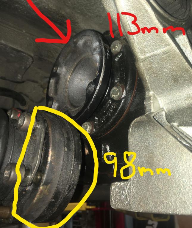

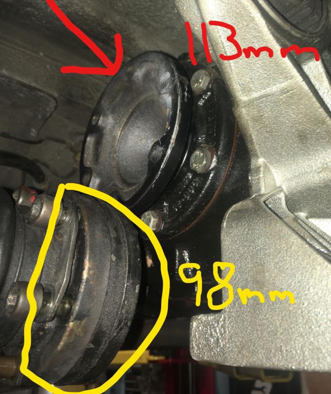

    Hello. I recently purchased an '89 e30 318 Touring mid-project from a guy in CA (the car is CARB certified) and am finishing what he started. I bought Rosie with all sort of goodies the previous owner purchased but never installed. One piece is a finned rear diff. Rosie came with a rear diff from a '98 z3 M & the Garagistic adapter kit & magnetic drain plug. So I realized last night that the 318 rear axle flange is a different diameter than the z3 diff, the z3 is about 3/4" greater. It looks as if everything should match up except for where the rear axle connects to the diff. Does anyone have the correct rear axles for sale?

    You probably want flanges from an appropriate car as any decent axle can deal with an S50/2 even if you drive like an idiot with sticky street tires. IIRC E30 medium case flanges slide in.
    Try to verify what axles you actually have first in case the PO changed them.

      RogueToaster- Thanks. I need to ID what I have and double-check that E30 med case flanges fit my needs.

ID:	9952640 My existing axle, the flange that bolts to the diff is approximately 98 mm whereas the diff I'm installing has a flange diameter of approximately 113mm. Does anyone have a left & right rear axle for sale that has a flange diameter of approximately 113mm? Thanks Click image for larger version
