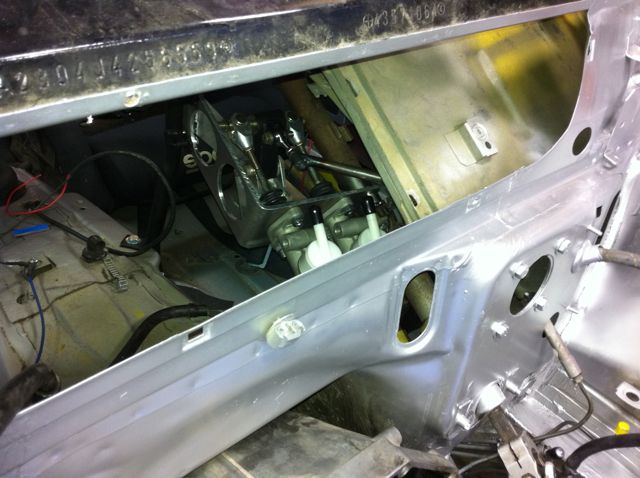

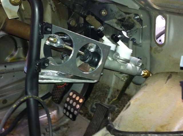

    Well, I guess my build is a hybrid then, because I'm using the new Wilwood cantilevered triple MC setup in mine and it won't see track time, Lol! I decided on this pedal setup a long time ago to get the brake system out of the engine bay and be able to control the bias a little better, too. With the V8 being so wide, this setup just made more sense to me. I don't dislike the remotely mounted booster/MC setup I had started with originally, I just think the Wilwood setup will look cleaner under the hood and function far better and be way more adjustable...

    There's a lot of stuff we're doing that won't work on a street application. For example, a cockpit-mounted dual master cylinder w/balance bar. Picture attached.
    -Bruce
