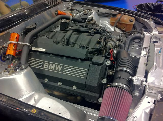

    Well, finally got fire in the hole today. Despite a full re-wire of the entire car, everything pretty much worked (don't forget to plug the two vacuum ports at the base of the throttle body, btw).
    The only strange thing - getting unusually *high* oil pressure. Through the mechanical gauge, we're getting 55-60psi at idle, and over 80psi as soon as you add a couple thousand RPM. Oil is Mobil1 15w50. Thoughts?
    -Bruce

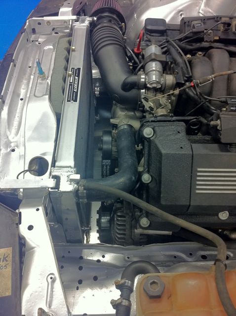

    Is that a Mishimoto E30 radiator?

              Originally posted by dirty30
              Congrats!
              Yes - an e36 M3 Mishimoto. This car won't be sitting in traffic running the AC, so this radiator should be sufficient. At the price, I would consider trying this radiator in a street car (with careful shrouding), before doing a bunch of heart surgery to fit a wider radiator.
              -Bruce

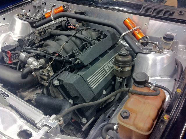

                          May I ask why the stock PS reservoir remains after all the AN/JIC conversion discussion/work?

                              Originally posted by bimmerteck
                              Looks good! Can't wait to see a few lap videos.
                              It's mostly a function of time and budget. The reservoir will get swapped out, but it's really the high-pressure line that drives the AN decision. The output of the pump is a -5 hose and metric banjo. Our local hydraulic shop was not sure if they could even source that type of hose end.
                              -Bruce
