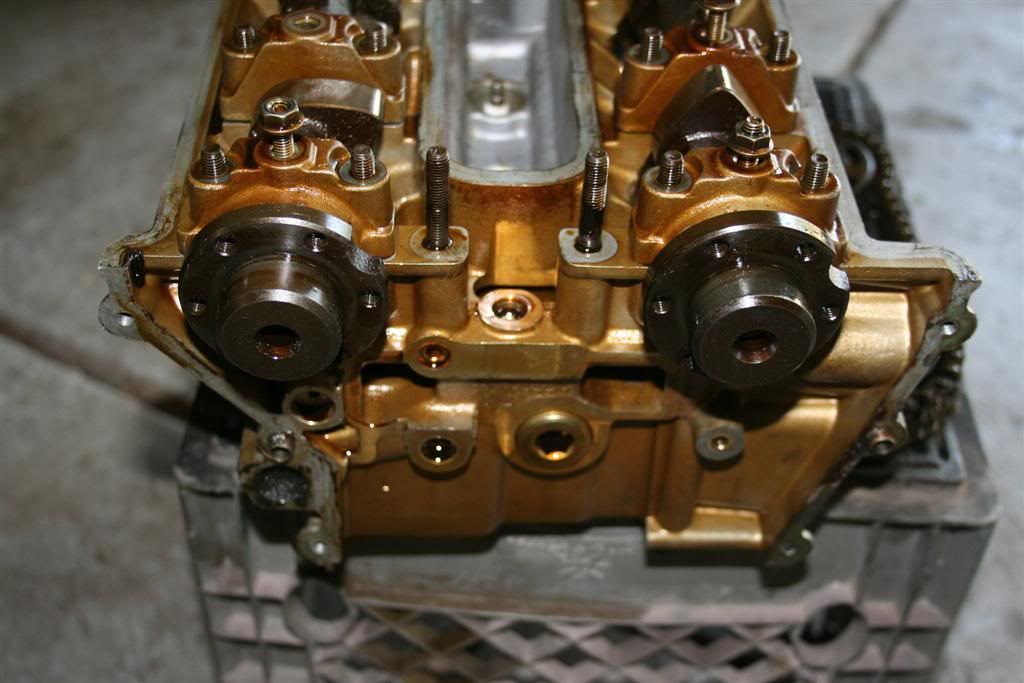

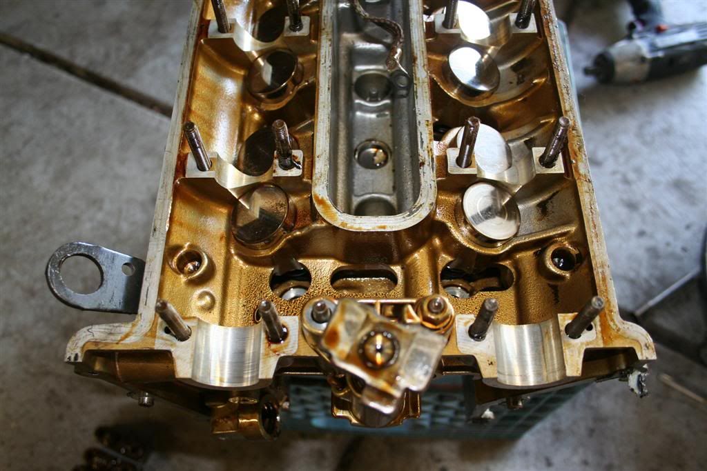

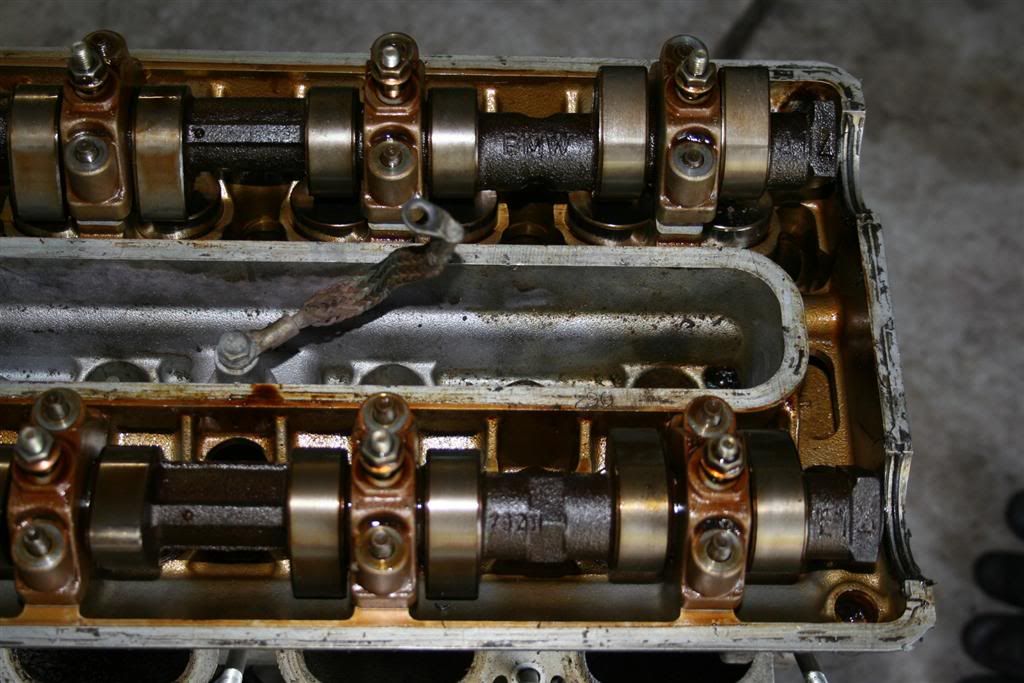

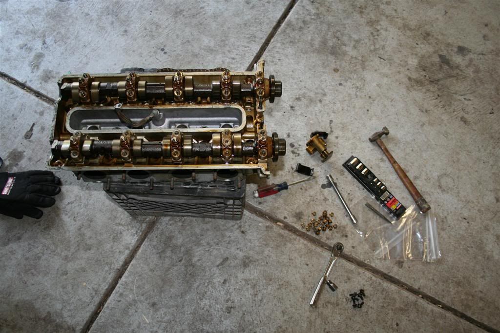

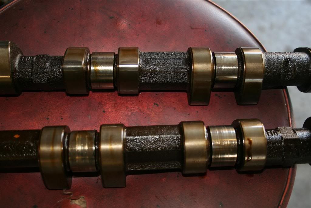

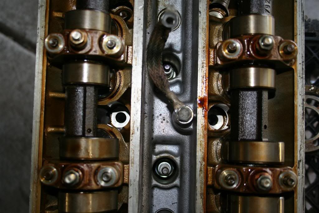

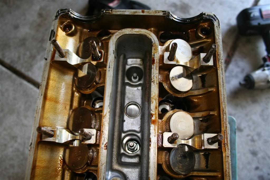

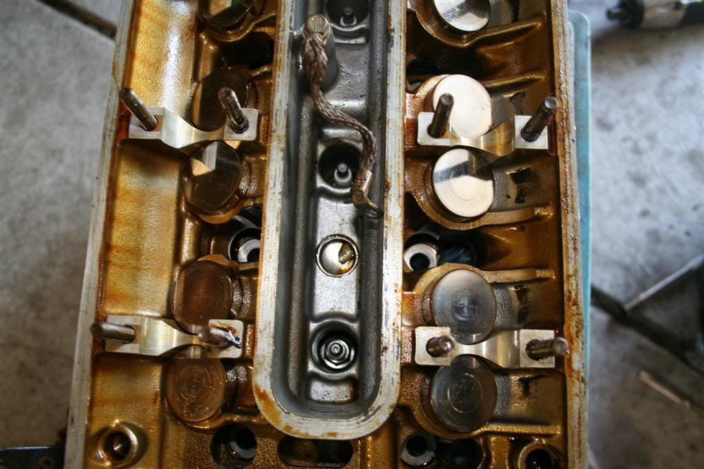

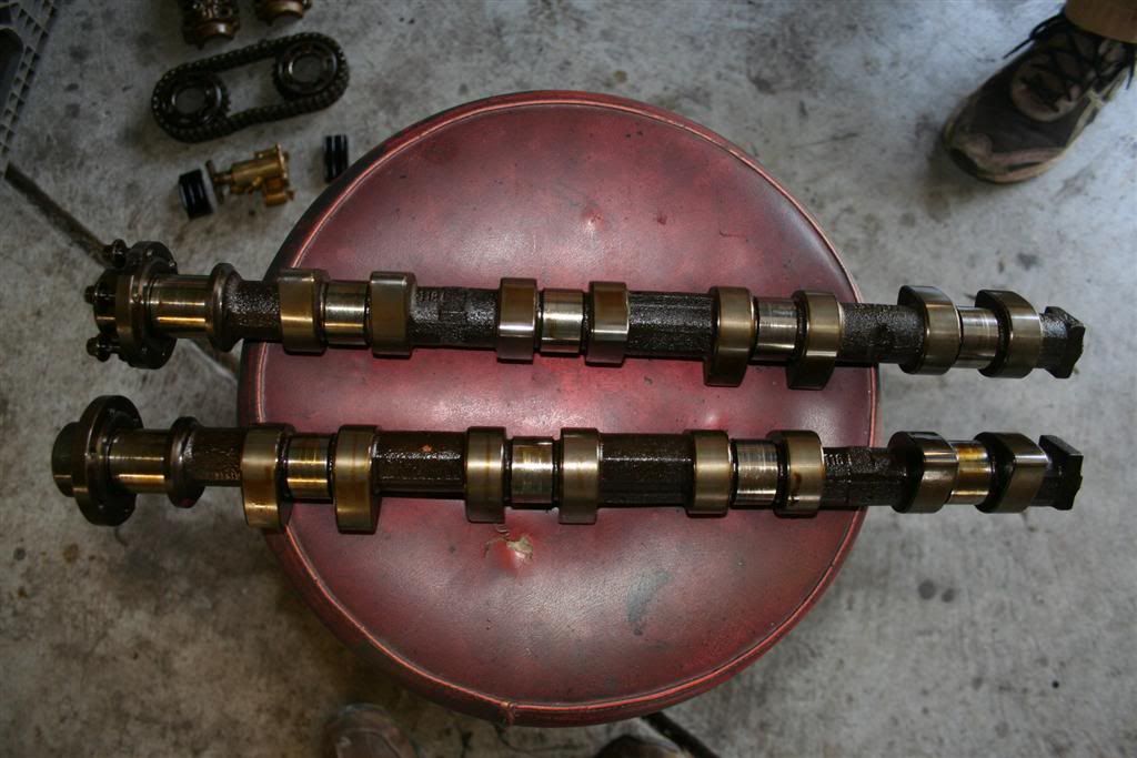

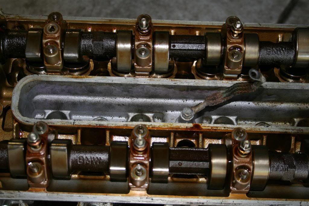

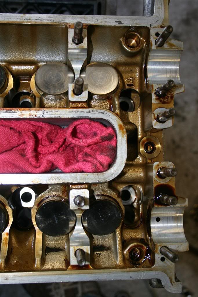

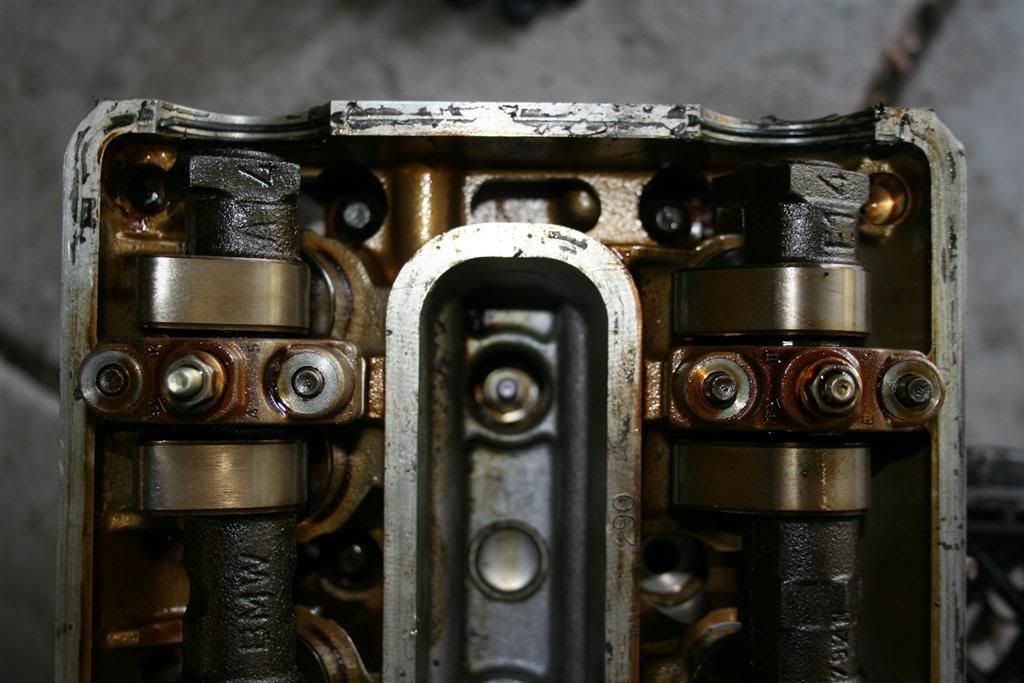

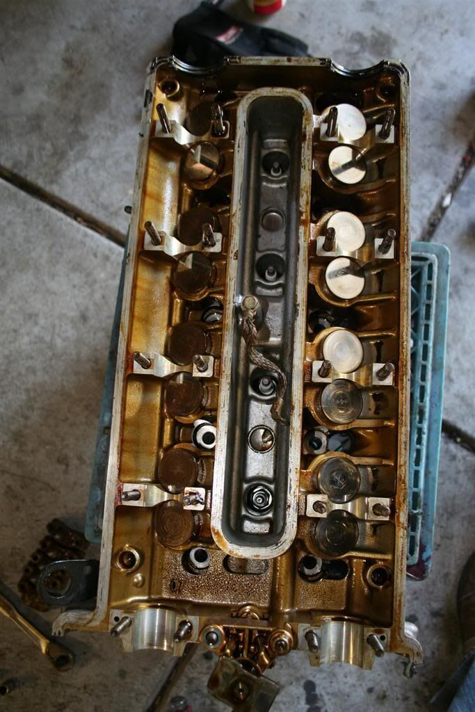

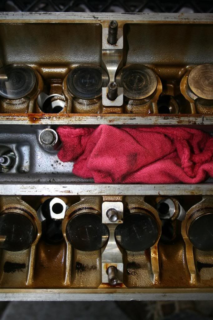

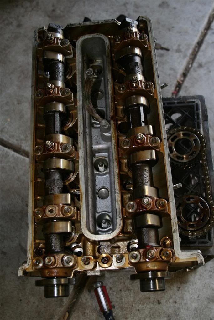

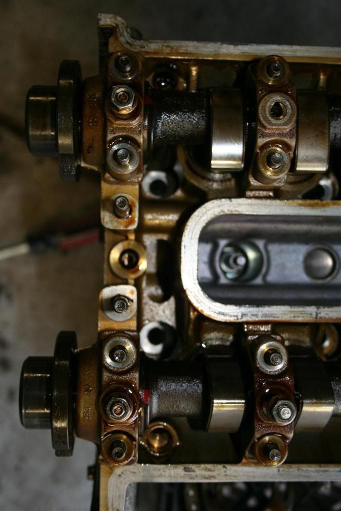

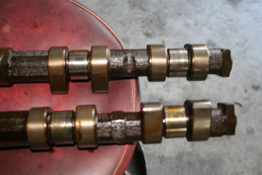

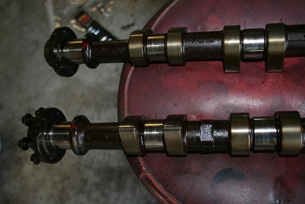

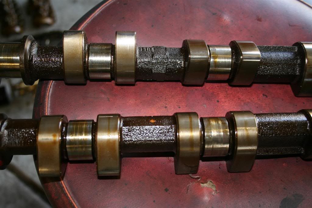

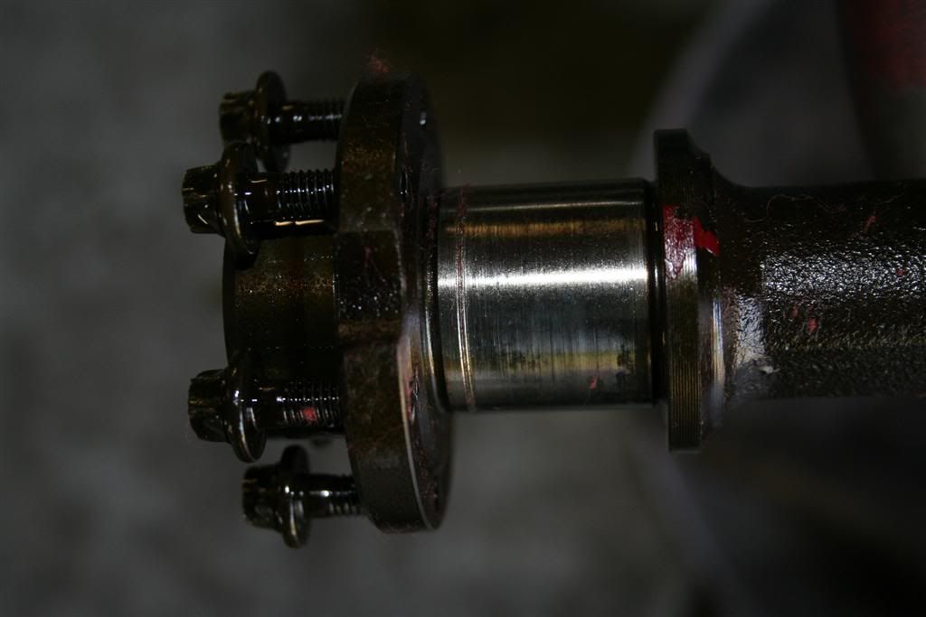

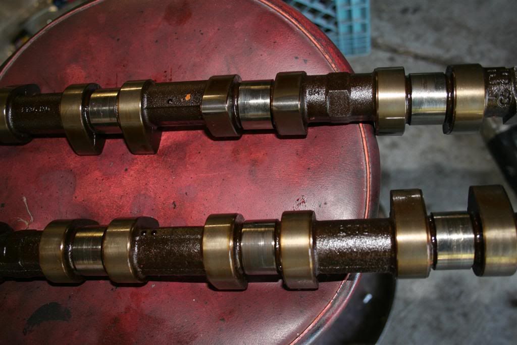

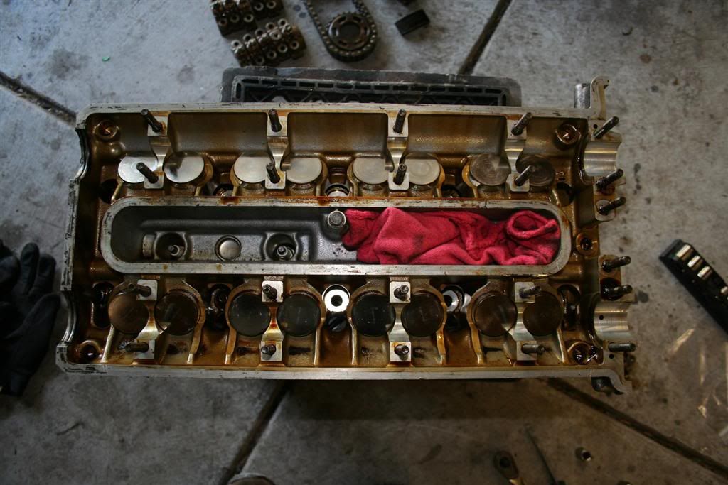

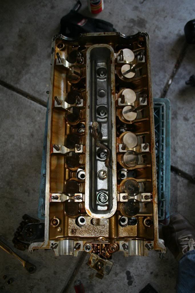

                Various metal parts dropped off for blasting/cleaning.
                Took the cams out today to inspect, two have some scoring on bearing surfaces , lobes look clean w/o any issues and same with lifters.
                I am going to pull two cams out from another engine, and bring the heads over to the machine shop next weekend for a rebuild.
                Pics.
                Passenger side head.
                cams pulled
                camshafts
                cam/timing hardware
                cams from driver side head
                problem area
                head

                  so those cam's can't be repaired huh?
                  • Jean
                    • 18228
                    I am sure they can be, but It's just cheaper/easier to grab another set.
