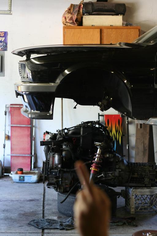

                Still happening, just had to put it on hold to take care of my daily driver, concentrate on job/school, and other things like that.
                In the next week or so the e30 will have an empty engine bay and that will probably push me to work on the swap :)
