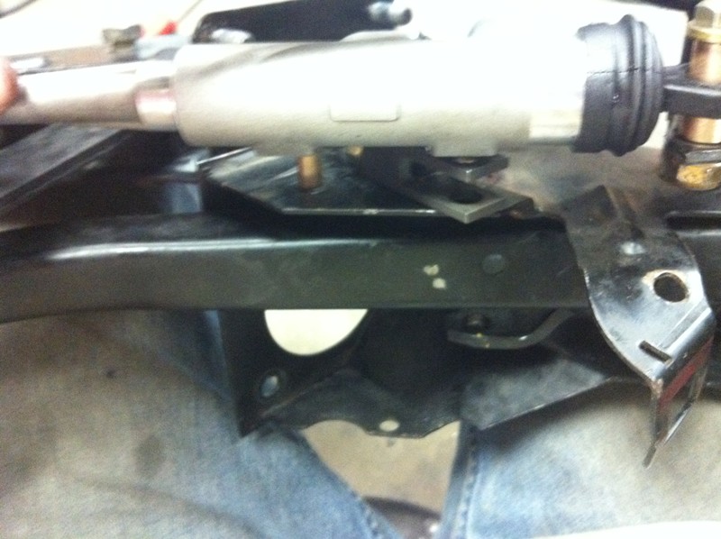

    I got some proper hardware to mount the MC today. I'm going to try to find some stainless spacers for the final version, I got the brass pieces so I could easily cut/grind them for fitment. It's very sturdy, doesn't flex at all. Not sure if that will change when there's actually hydraulic pressure...
    I need to work on the movement of the arm that reaches in to the pedal. Right now, it can fully extend and retract, but not in the arc that it will be moving in when attached to the pedal, it would bind up on one of the MC mounting bolts. So, I either need to have a pivoting attachment point on the pedal to allow the arm to move along it's own path, or move the pivot point on the firewall bracket to allow for more movement of the arm. I also need to trim down the pedal bracket, as the pedal and clevis get seperated by it when fully depressed. I'm sure none of this makes sense to anybody, unless you have this exact setup right in front of you. haha
    On to the pics. New hardware:
    Pedal and arm fully extended:
    Pedal and arm fully depressed:

      The one thing to keep in mind here is that the pedal arm, unless something catastrophic happens, will never be fully extended or fully depressed. Actual effective travel is minimized to a much smaller arc. What you need to figure out is how much actual pedal travel is needed to effect maximum rod travel at the booster. That will give you the real travel arc of the pedal arm...;-)

        Yeah, I would just hate to run into a situation where a brake master cylinder went bad or something, and I needed the additional travel, but was limited by binding of the linkage. I think it rests at the fully extended position, or very close to it. The brake light switch and bracket seem to be the 'stop' for that.
        I have another idea instead of those spacers, which would give me all the clearance I need for the clevis, and provide a more solid mount for the clutch master cylinder.
        Will report back tomorrow :)

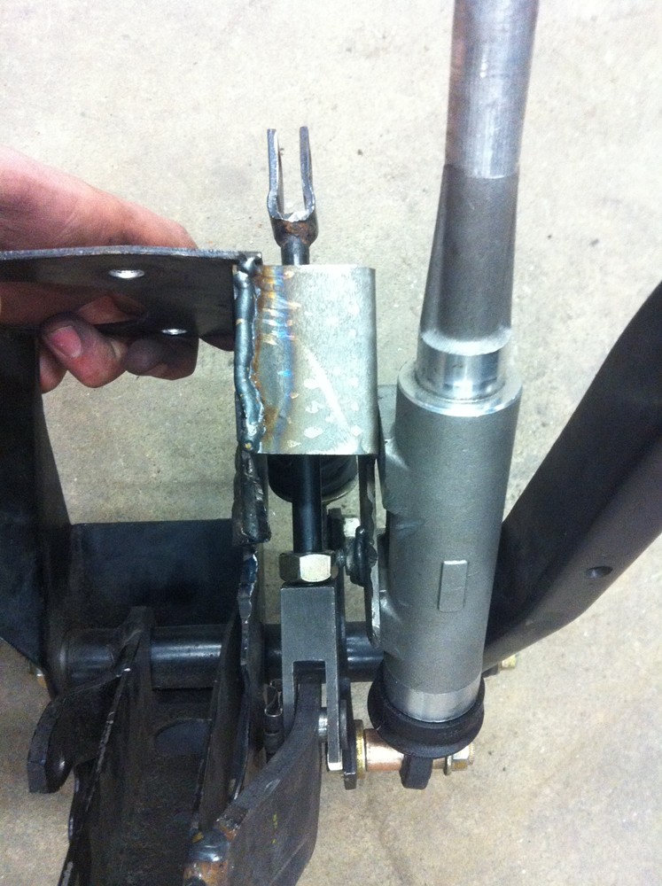

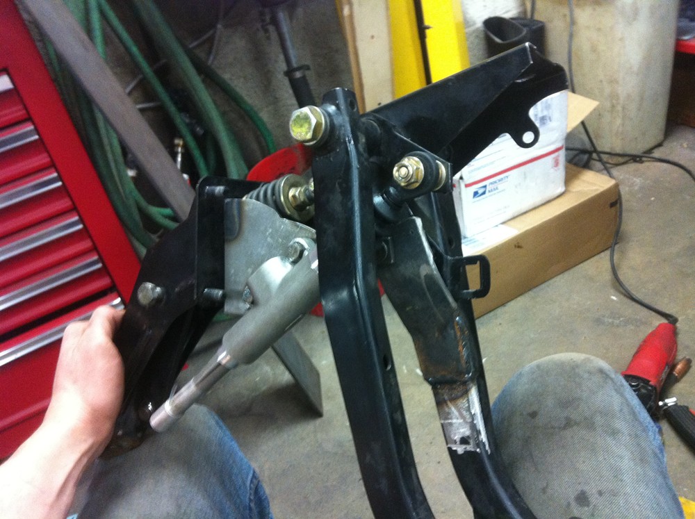

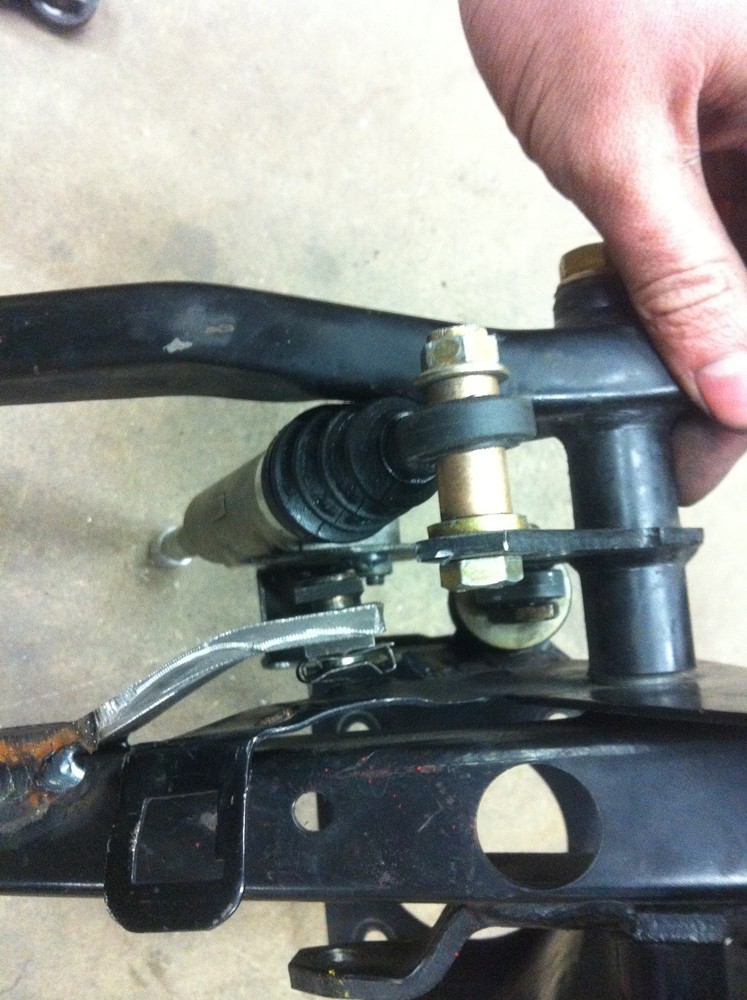

                            Made some good progress today. Ditched the clutch master cylinder spacer idea and built a separate bracket to space it away from the pedal box, so that I have full clearance for the linkage. I had to cut and grind in a LOT of places to make this all work. I now have full pedal travel, only limited by the e34 linkage parts themselves, so I will have the same travel a stock e34 would have. I was able to connect the linkage at the same height on the brake pedal as stock, so my pedal effort shouldn't change either.
