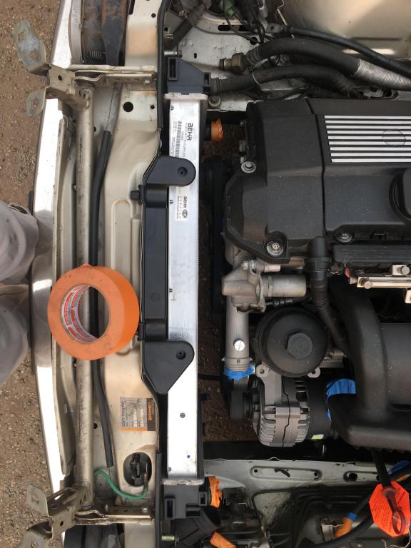

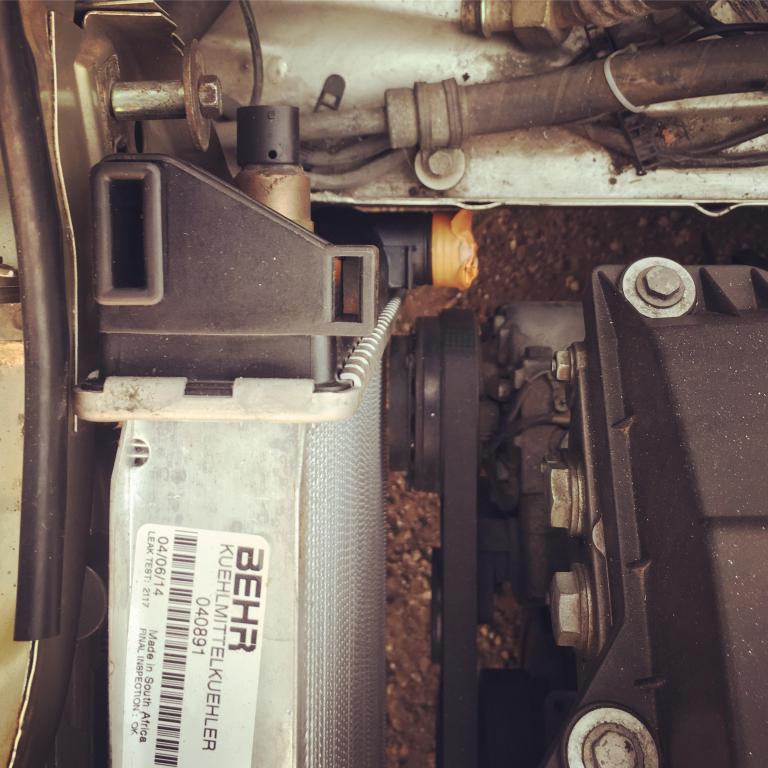

early model e30 m52b28 sway with the mz3 rad. Ive got Samco silicone e36 m3 hoses and have some issues with fitment. seems im going to have to trim them quite a bit to make them fit.
Also have about 5-7mm clearance to ac comp. and barely enough room to get the hose on the inlet... am I F'D or do i need to try harder here hahaha
Any intput much appreciatedComment
