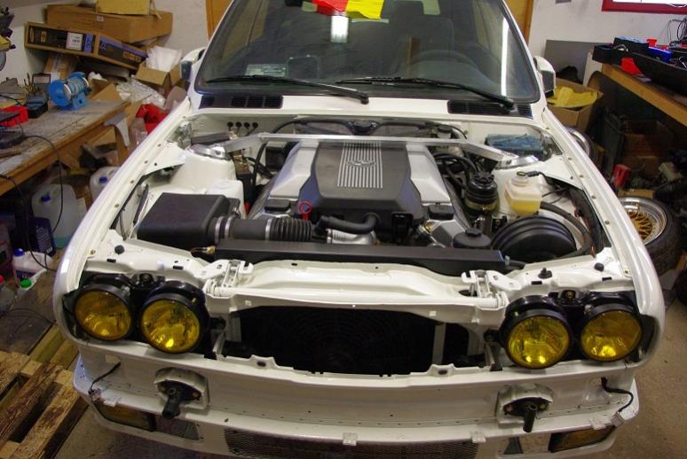

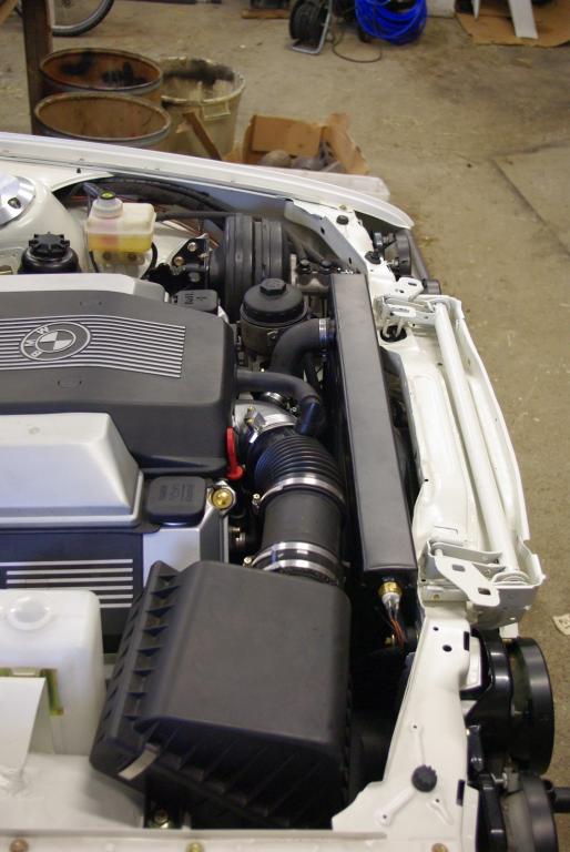

                      • Jonsku
                        • Oct 2004
                        • 566
                        #41
                        Originally posted by noid
                        I just thought about this.... 2.4" thick is 61mm that's HUGE. The PWR monster is only 57mm.
                        I am quite excited to see if it fits without modification.
                        My rad. is 65mm thick and fits with the V8 (position ~2) very well.
                        That Mishimoto rad. with 2 fans looks very good, though I suppose the other fan won't fit as there's a "bulge" in upper LHS corner of the "rad. opening"..
                        - E34 M5 (x 2) -
                        - E30 V8 Cabrio "Kylpyamme" -
                        - Alpina D10 Touring #33/94 -
                        - E46 318i Touring -
                        - Toyota Hiace 4wd -

                              • Jonsku
                                • Oct 2004
                                • 566
                                #45
                                Originally posted by bmwmech1
                                Jonsku, I assume you're using a front mounted pusher electric fan and no engine driven fan as you said the engine is too close the radiator. Can you confirm this? Do you have the fan set up on a thermal control or the original variable speed control? Any pics?
                                Garey
                                Yea, there's no space for fan between engine and rad. Last summer I had 14" pusher fan with temp. sensor in rad + additional "must run" switch in the cabin.
                                For next summer I plan on putting SPAL 14" high-performance fan with SPAL control unit so I'll have variable speed and can set the temp-limits myself. I'm swapping the SPAL-things to the car because I found the "fixed temp" sensor is more or less never right (it starts or stops too early / too late), so now when I can adjust the temps and revs without limits I should get the result I want.
                                Long explanation, hope you understand what I mean :)
                                I'm on a business trip at the moment so can't upload good pictures to my site. Anyway, as attachment there are couple of pictures from the project-phase. As you can see, there's not too much space between the engine and rad. I remember someone in Germany using "engine-driven fan", though I guess it was from some other model as it has to be very slim. Also, I think you could fit some kind of "super slim pulling fan" between the engine and rad., but where's the sense in that when you can fit full-size pusher fan to the front-side.
