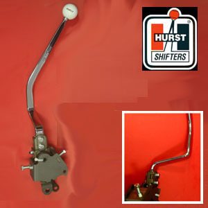

                      I caught flack when i wanted to put a 305TPI in my first e30. But i didnt care what others thought, cause most people on here turn their noses up at domestic iron. Eventhough a 305 isnt really a power house in the first place lol. But as for the 4 speed. Will the shifter clear in the tunnel? Along with the shift rods? Cause all of it is mounted to the side of the trans.
                      And being that the shifter is off center, hows that going to be for clearance? And where will it pop up in the car?
                      But if it is close, a console shifter handle may work. To put it centered in the car.
                        http://www.speedwaymotors.com/RS/SR/Product/4407535_L.jpg
                        http://i1.ebayimg.com/03/i/001/1d/11/cbdb_35.JPG
                        The beauty of the external shift linkage is that you can shorten or lengthen the rods to put the shifter wherever the hell you damn well please.
                        But that would be my only guess about a serious issue with using the Muncie in the E30 body... transmission tunnel clearance.
