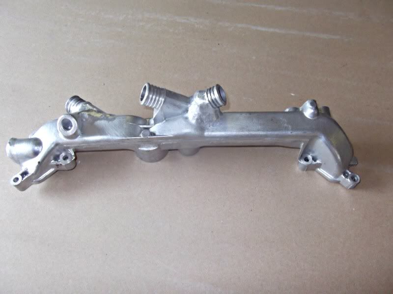

    I'm having much difficulty bleeding my coolant system. As in, I've spent over 5 hours dumping water in, watching it boil out and overflow, and repeating. Everything is new, water pump, thermostat, hoses, radiator, reservoir, block/heads were flushed, etc...
    I think I found my problem this morning. I had my coolant manifold modified, so the normal reservoir outlet (far right in the below pic) was blocked off and welded shut. The far left outlet was then hooked up to my reservoir. However, I noticed that port is actually directly connected to the smaller coolant pipe that runs up the the front of the engine, into the water pump. The "normal" reservoir outlet is on a different "circuit", as you can see in the pic.
    So what I think is going on, is I'm feeding water into the "out" side of the water pump, so it's just pushing the water back into the reservoir and not taking any new water, and not pushing the air out of the system.
    Thoughts?

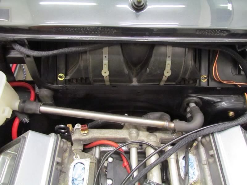

    The small downward facing coolant nipple on the drivers side of the crossover pipe should be the heater core inlet in your application. I think you are forcing coolant into your reservoir the way you have the heater core hoses set up. Think of it this way:
    The small pipe that runs in the valley is the feed so it is recovering coolant from the heater core and the reservoir. The large pipe has pressure from the water pump, it feeds the cylinder left and right banks and the heater core. You should have the small drivers side outlet that originally fed the trans cooler hooked up to the heater core inlet and the other off of that "Y" being used as the return from the heater core. I'll post a picture of mine but I had Gary set it up totally different.
    The large port coming out of the top of the driver side goes to the bottom heater core inlet on the firewall. The drivers side facing port on the "Y" goes to the top port on the firewall. The other side of that "Y" is my inlet from the expansion tank.
    Here's another pic I think I stole from Jonsku that helped me a lot:
    Hope this helps!

      So what you are saying is, I have it hooked up correctly? I didn't actually verify my input/output on the heater core yet, I just drew that picture under the assumption that that small pipe was pressure from the pump. The heater core lines are easily switchable, I'm not too worried about that. My only concern at this point is to verify coolant is flowing from the reservoir into the system properly. And from your description, and Jonsku's pic, I have it set up properly.
      Something has to be wrong, it simply will not bleed at all. I can't imagine (potentially) having the heater core lines hooked up incorrectly would cause this? Or am I wrong? After 5 hours of filling and bleeding, I'd think all the air would find it's way to the highest point and escape. Both heater core pipes on the interior are hot when the engine is running and I turn the heater on.

            I just found a pic I took when I was installing the heater core lines. The drivers side facing port on the "Y" goes to the top port on the firewall, which is how you and Jonsku have yours set up. So everything is hooked up correctly.

              Interestingly, it appears that Garey has his set up the opposite of you and I. He has his reservoir connected to the main pipe, not that separate Y pipe. You can see where he welded the nipple on, up at the far end of the passenger side, past the sensors.

                The heater core hoses were backwards. I flipped them, and spent the past 2 hours trying to bleed the system. It's doing the same fucking thing is was before.
