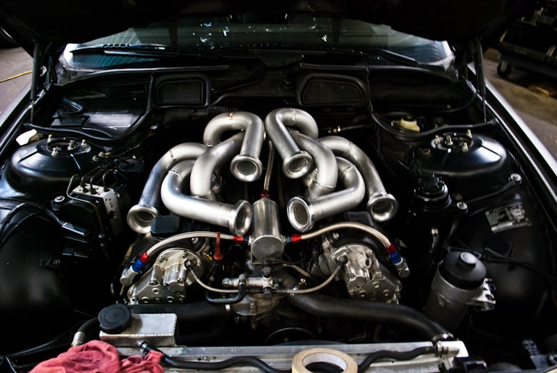

    Also, please do something insane, like this, with alpha-n.
        It might but it looks like it would be better if I just went ahead and worked with my machine shop buddy to create a design I can reproduce on the CNC.
        And those trumpets are crazy.. where would you find stuff like that? Love that oil separator idea too.

          FMU, FluidMotorUnion. The car is named "Gold Wheels" it's a 7 Series with s62 and it has electric cutouts...
          They make all sorts of wicked plenums, they did Mike B.'s s54 intakes too.

            Wonder why they did this? Mustta been some point to it, or maybe didn't like plastic ha.
            • Farbin Kaiber
              Lil' Puppet
              • 29502
              I think the reason was hood clearance with equal length runners.
              • dirtysix
                • 806
                Look to be about the same height as factory runners?
                Also look to be slightly longer, maybe they found something in that.
