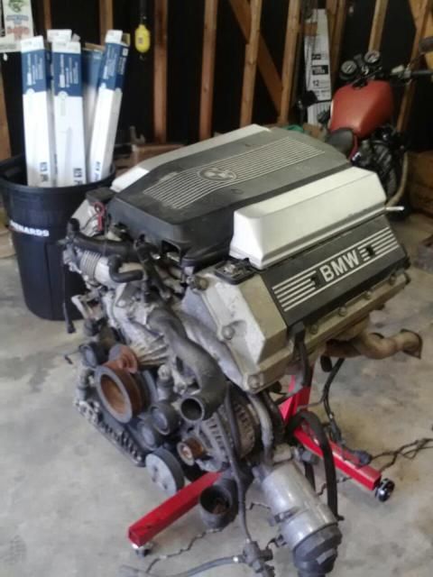

    I bought a m62b44 from a 97 740il (auto) for cheap yesterday, and ordered a #404 ecu
    I plan to switch to a manual but haven't bought a trans, flywheel, or clutch yet.
    My questions are: Do I need a different harness to use the 404???
    What about the crank sensor differences? (can't tig, don't want to have it done really)
    Has anyone here used an auto harness and could kindly enlighten me on what i can eliminate.
    I'm making the assumption that once I get my c101 adapter made and main powers/grounds in place what ever is left over can be removed/ignored?
    on to breaks: I can get complete m.c./booster/linkage + pedal system from the donor car (remote m.c.)
    Looks like a lot can be used there? I read on (mikes???) build with all e34 parts all he had to do was slot the firewall and modify the pedal plus mount the m.c. to the sub-frame.
    I need different manifolds right??? x5? Has anyone tried to fab their own headers? (I have lots of time and a welder)
    Lastly is there any gents here that would like to share some rough dimensions on motor/trans mounts (going with a 6 gear so i can look like i'm in the movie fast&furious and shift 26 times in one drag race) j/k but i know the 6spd makes life harder but can't find a 5spd 280, 420g are widely avail it seems.
    Source me a 5spd for less than $500?!?
    Thanks for all your help. :mrgreen:

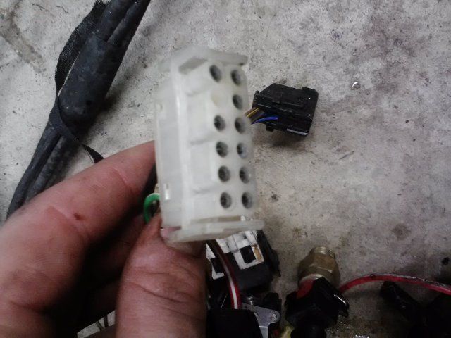

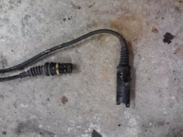

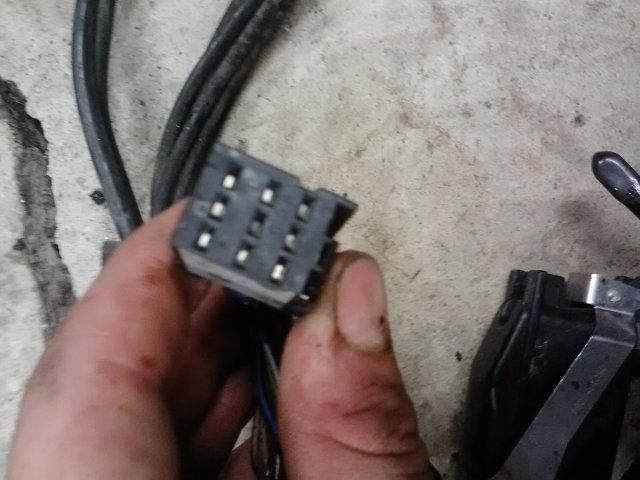

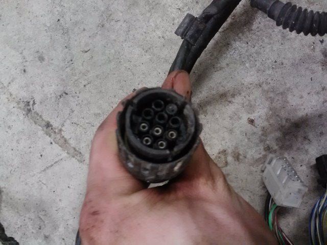

              OKAY so...a #404 DME will not allow the 4.4 to have all its power and will need a tune. Also have to fabricate a crank sensor to the front of the block and buy a m60 crank pulley, modify the harness...yadda yadda. This to me is a tie with having EWS as far as being a pain in the ass. So for now I cancelled my order for the 404.
              Would it be easier to leave the harness alone and install EWS?!?! it won't be cheaper, sense I will have to buy the matching EWS setup with the #484 DME.

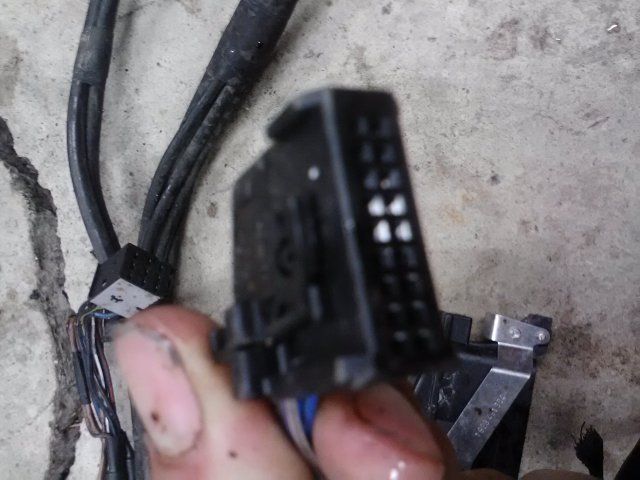

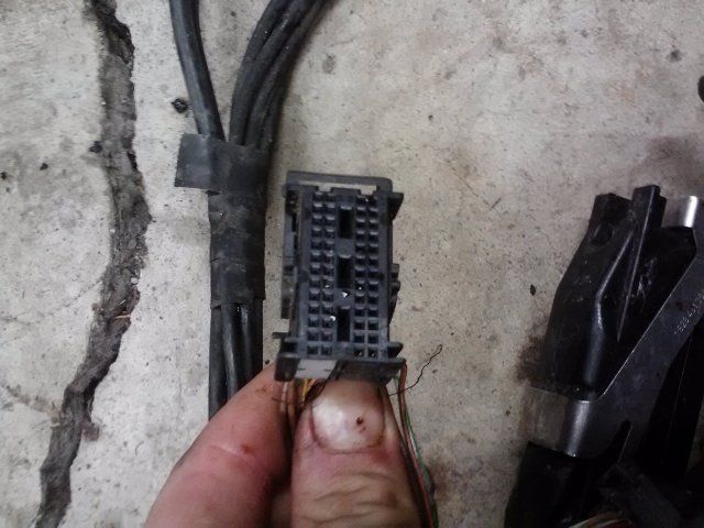

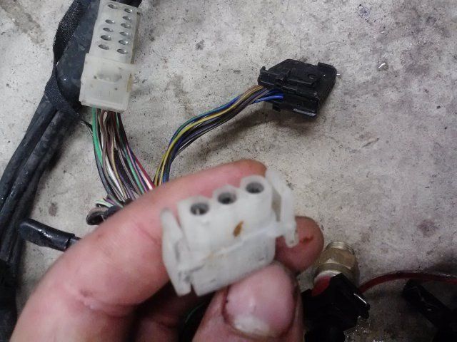

              From what I can tell all the plugs for the EWS are on the engine harness near the DME?!?:?:
              Please Identify:
              #7 (there are two pairs of these, they will connect to each other, they are on a very long strand from the harness by themselves)
              EWS is cool anyways, until you lose your keys.
              Of course its going to cost too much! But money is like manure, it doesn't do any good unless you spread it out. And at least I'm not like a lot of 19 year-olds and spend all my money on drugs and alcohol...
