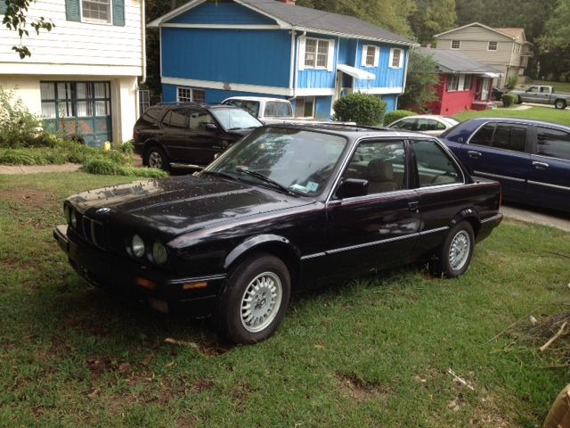

                      So the M62 is not worth the trouble? I was really looking forward to the ~30 extra horses (am I wrong in that number? No time to double check). I'm just trying to get the most power I can out of this thing while trying to stay within $6000 total (car and everything). Here is the "shell" I've been looking at - it has a trans and motor but both are virtually toast, to the point I was told to bring a trailer. What would you guys offer on this?

                        What would you guys pay for that car in my last post? Engine and trans are both in need of repair or replacement (I will replace) rear bumper has damage, that's all I know for now will be checking out the car weds.

                          I have trouble paying over $1000 for an e30 that does not run with no bonus go fast parts. Anything less than $500 is scrap value so somewhere between those two. At a glance the car looks straight and is a late model which is a good start. I would rather pay 2k or more for a really clean one with a sport package and perfect paint interior etc. than a beat up car. A beat car that is cheap will have cost control issues just like an m60 vs m62.

                            Save yourself some time and money and buy this car your 6k build will turn into the 10k real fast. for 10k asking price you couldn't build this
