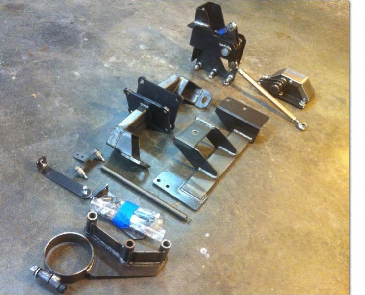

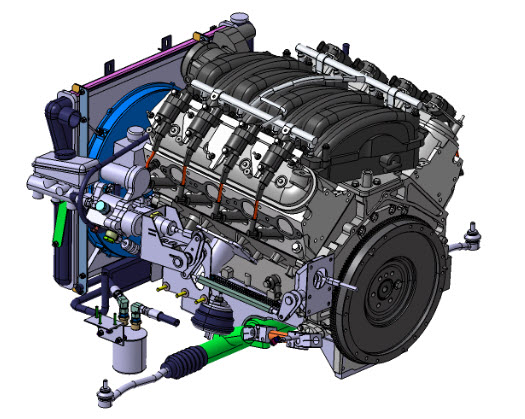

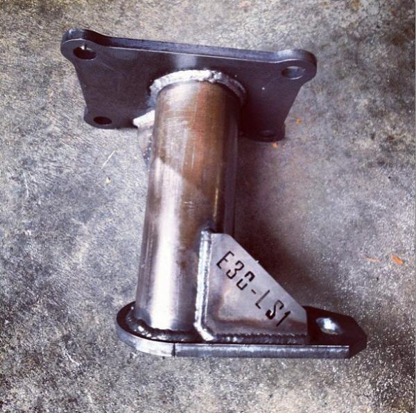

    Hi Swappers
    A couple pics of the Gen3 E30-LS1 engine mounts, and a Catia model of our stuff on an LS3 --- Enjoy!

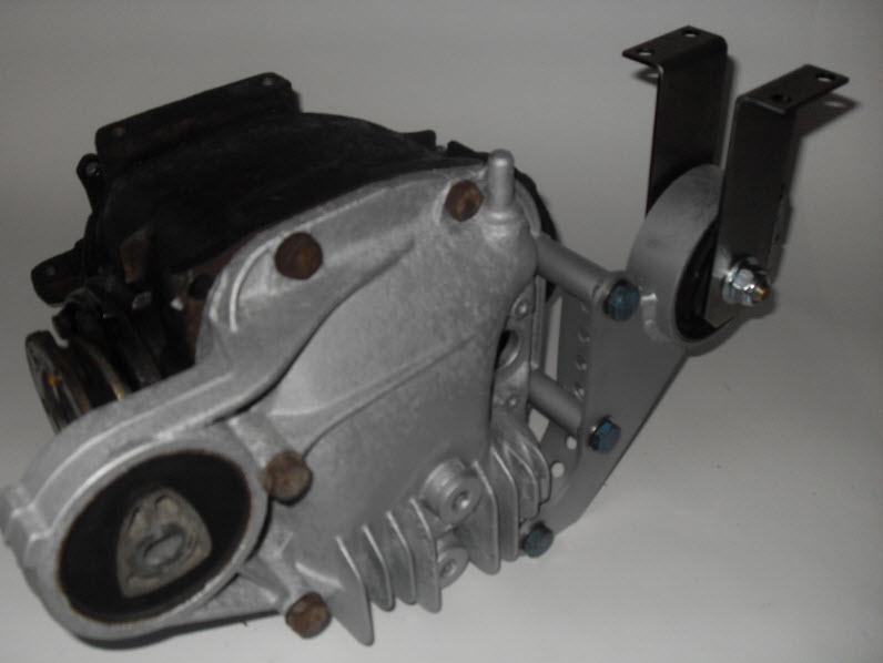

            Does your diff mount clear an m coupe diff cover?
                Our diff mount uses the three bolts at 2-4-5-o'clock. On the non-m cover, all of the flange is the same thickness ~~ 10mm. On the M-cover, the bolt holes we use have a different thickness (looks like about 30mm or so from the pics).
                Give us a measurement of the boss height for the above bolts, and we can make a custom mount for the M3.

                      The kit (see attached pictures) costs $1499 (plus $40 domestic
                      shipping) and includes:
                      Engine Mounts : 395
                      Transmission Mount: 350
                      Booster Linkage System: 525
                      Second Differential Mount: 285
                      Radiator mount: 125
                      Swap Guide CD: 99
                      Just a little project im working on
                      - http://www.lse30.com -
                      • vert_this
                        • Feb 2012

                            • garretvs
                              • 464
                              Announcing price reduction to $1195!! Simpler engine mounts made a difference to us, so we are reducing our kit price back to what it was! We also include laser-cut water pump spacers, as well as the CD. Get some real ponies under the hood!!
