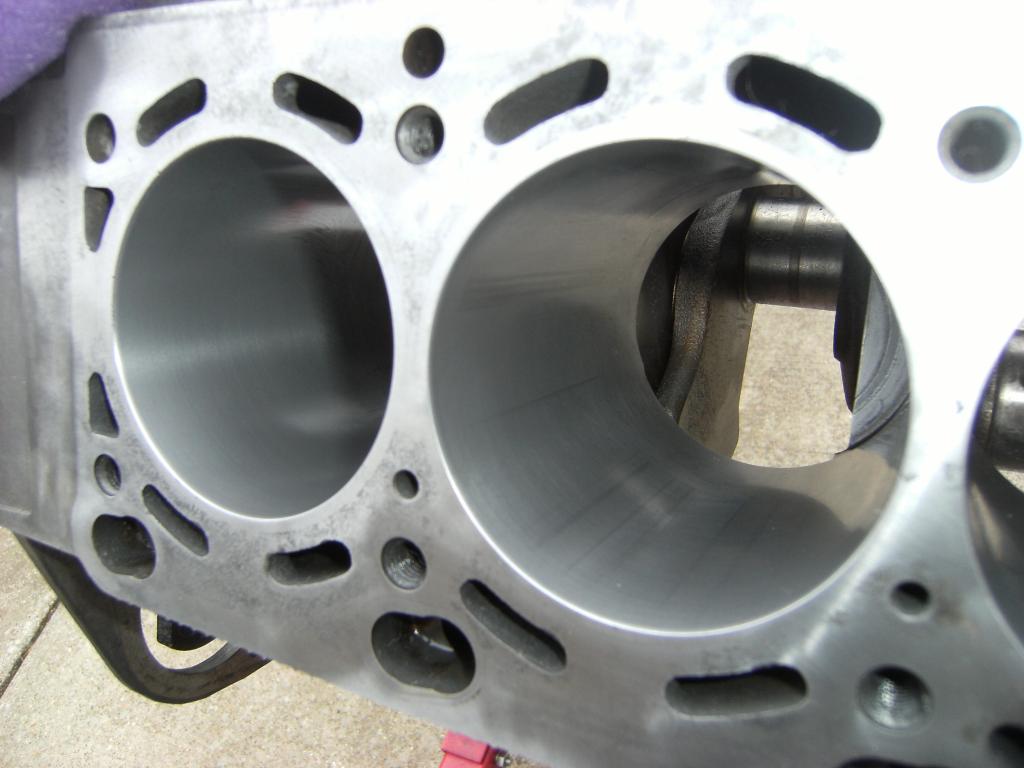

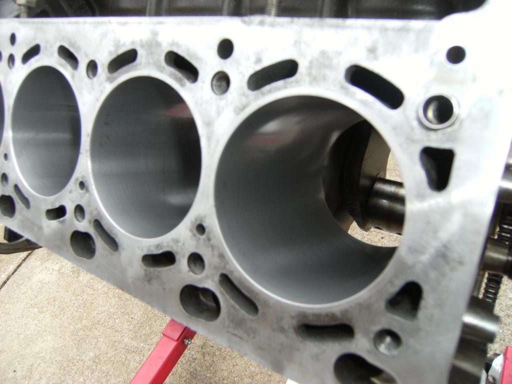

                              Cylinders after the initial "hone" with the steel wool wrapped hone stones.

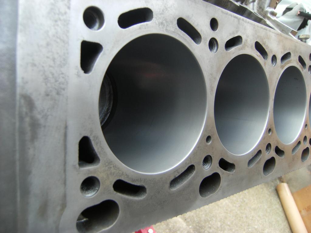

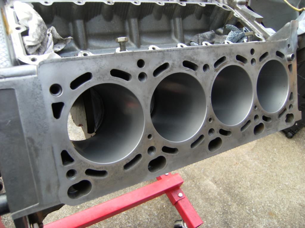

                              Cylinders after the final "hone" with the felt wrapped hone and the Sunnen compound.

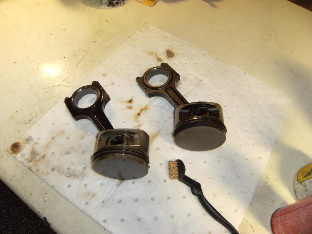

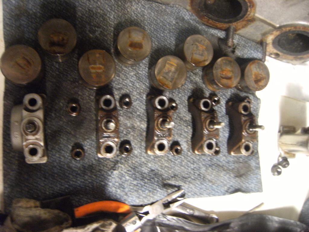

                              Here are the before cleaning and after cleaning of the pistons. After inspection, I am just cleaning and reinstalling these. Only changing the bearings and the cap bolts. The rings look good and will save me $3-400 as the cheapest I found for new rings is about $35 per piston!!
                              All the pistons were soaked in kerosene for about a week (I forgot them!!) and then scrubbed and inspected.

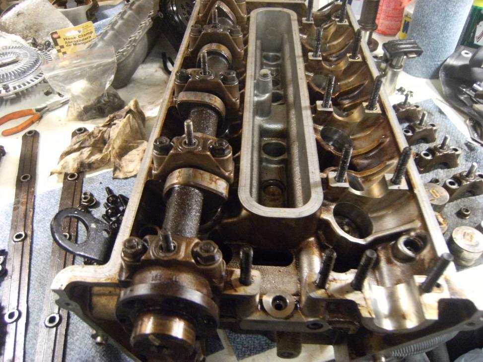

                                Here is one of the heads as I started disassembly:

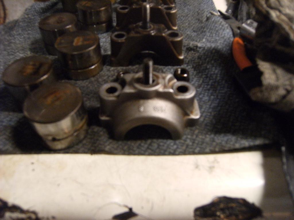

                                I will get some pictures of the valves, lifters, etc tomorrow. I have them all cleaned and ready for reinstall. The only thing left on this head before final buildup is to lap the valves and install the new valve stem seals. Then on to the second head! Yeah!!!
