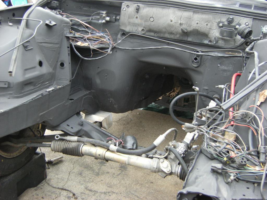

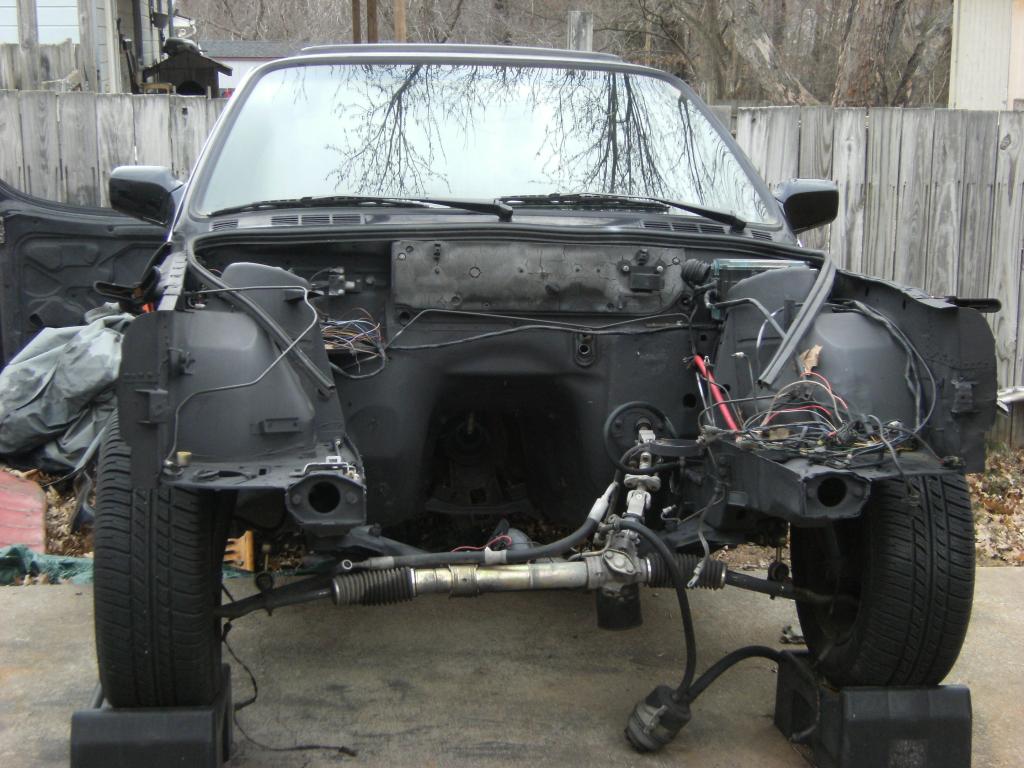

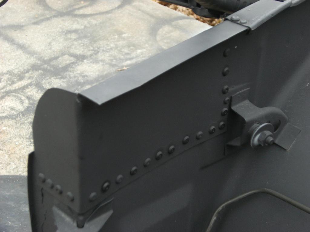

    Clean up of the engine bay. Split the wire harness to either side. Just have to finish tucking it. I also had to repair both front corners of the inner fenders as they were beat to hell!!! Have a new core support to install once engine is finally in its resting place! There will also be RD green sways installed along with Treehouse CABs.

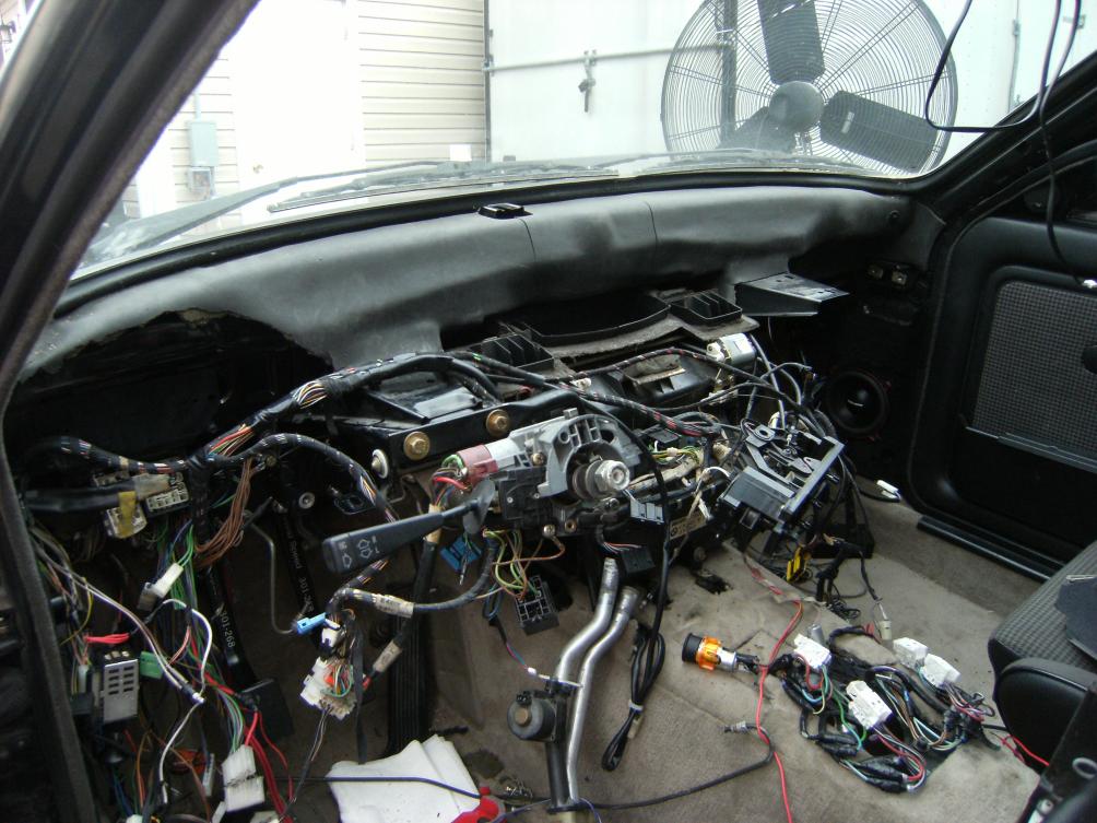

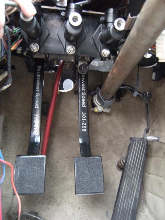

    I have my pedals installed but not finished yet. Have to finish the mod to the accelerator pedal linkage along with running the brake/clutch lines. Would have gotten that done this weekend but we go 8+ inches of snow!!! I also got some of the wiring rerun after taking out all the ABS wiring under the dash. Have the replacement dash just about ready to install as well. I have a new head liner to install as well as dyeing the carpet to match the houndstooth interior!
