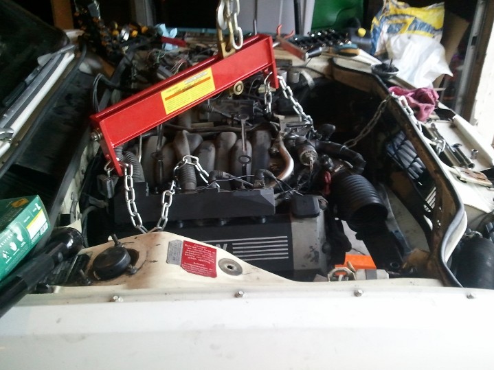

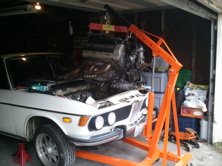

    And a picture
    Still looking for experience with manual brakes, but here's a picture of the motor in the car.
