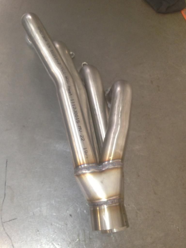

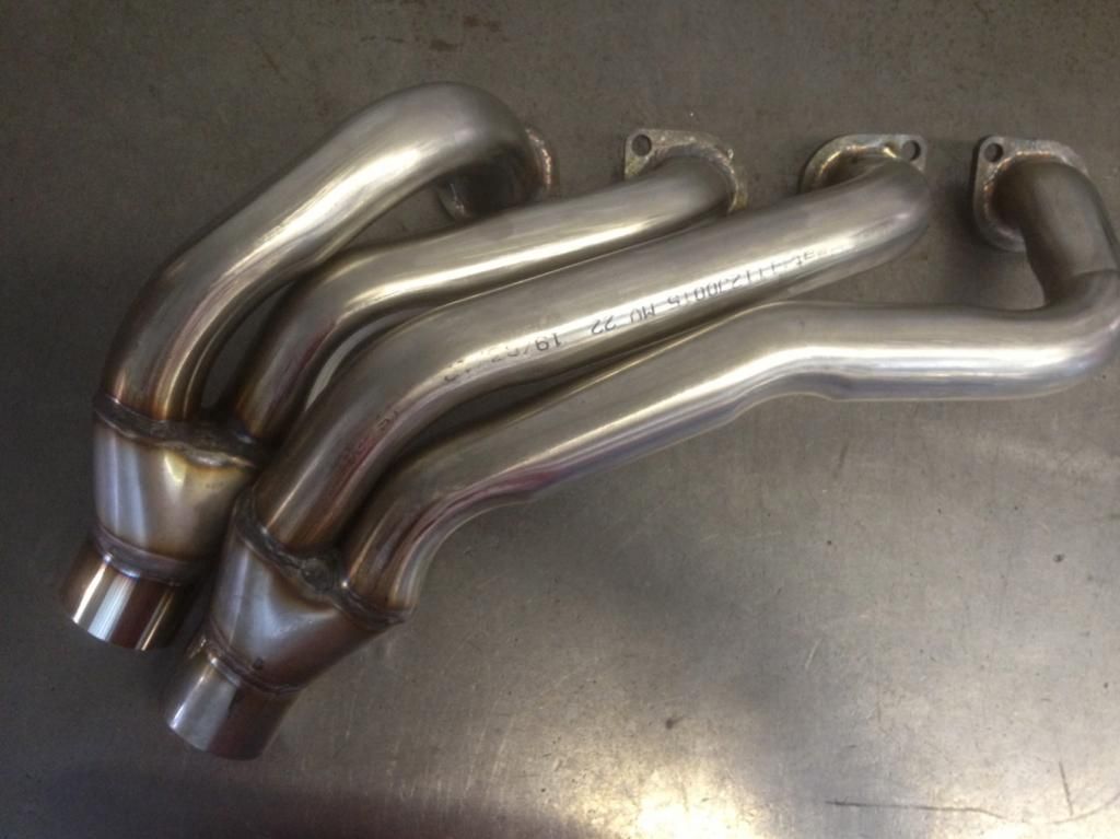

    Hi all.
    We have just released our E30 Ready V8 manifold kits and we'd like to offer all you lovely r3v'ers some money off!!! Fitment designed to fit M60, M62, S62 engines etc
    Just a quick rundown of the product -
    Made from 304 stainless steel 45mm tube
    Laser cut flanges
    minimal welding
    Available for right & left hand drive cars.
    Designed to work with E34 steering knuckle kits
    Designed using the 300mm.de engine arms
    Works with 10-20mm subframe spacers
    Supplied with a roll of exhaust heat wrap (up to you whether you use it)
    Available in both RHD & LHD
    Our forum and Facebook member price is £950 plus postage.
    We can also Supply a bolt on exhaust system to match. These will be made to spec so please get in touch with your requirements.

      Those aren't mandrel bent, son.

        Came to say this.
        Awesome product though, about time someone made a set of bolt on headers for this swap. Do you have any installed pictures to show the fitment?

              Also, they're definitely not mandrel bent. Take a look: http://www.youtube.com/watch?v=G9z2pAmk3XI

                        Description edited. Not mandrel bent my apologies.
                        Thanks for the comments guys, both positive and negative :) We always aim to improve our products moving forward and (constructive) input is always welcome :D
                        We feel for a bolt on solution to the V8 swap the pricing is quite reasonable. Especially considering 2nd hand, double wall'd restrictive oem manifold that you have to butcher to fit can be £250 on ebay (at least in the UK)

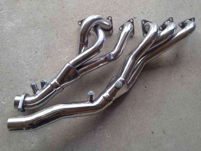

                          We can also offer them pre polished for those who arent going to wrap them.
                          Here is our S54 e30 Header kit:

                            The S54 headers look like the standard setup for an E46 (or even ebay headers). What is different about yours?

                              The S54 headers pictured above are the ones sold on amazon and ebay; one of the names associated is "sure win racing" - around $110.
                              they are also sold by VAC motorsports as a "direct install set" for $700. Pick your vendor!
                              A local friend just ordered some off amazon prime this jan (2013). We will see if the tolerances around fit is same as 2009; they are 100% made in china and not bad quality- never had an issue in 5 months of daily drive use.
                              Those headers actually fit great but the hardware and included gaskets are garbage.
                              I installed those in 2009, think it cost me less than $170 total to order all new parts needed:
                              (headers ~ $106 shipped, $65 for gaskets, nuts, new 42mm studs
                              notes from my 2009 s54 swap:
                              order these new parts:
                              18x 42mm studs from m50b25 needed; order 18 as the s54 is 3 per cylinder instead of 4 like a M50.
                              18x 11mm copper exhaust nuts
                              6x s54 exhaust triangle gasket
                              Don't even think about installing the china crap gasket/hardware joke on a S54; remove the plastic pack from the header box and drop it directly into the trash (do not even open plastic pack as it will contaminate your garage with garbage)
