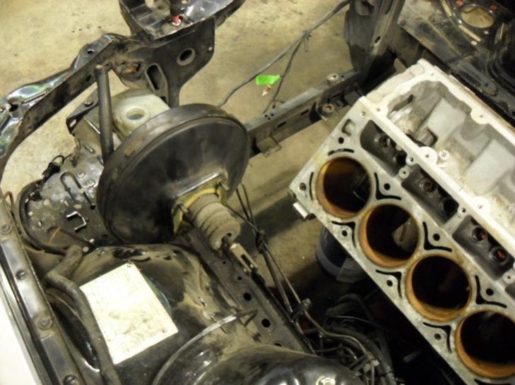

    I have it on there now, but not sure what I'll end up with. I have an IX booster and I've been playing with the thought of using that. I don't have ABS and don't have high beam headlight, so I may have room to fit everything with a little modification of the current setup which is supposed to use the Mustang hydroboost. Once I get the engine in I'll know for sure, but the headlight/ABS delete isn't an option for everyone.
    Picture below sort of what I was thinking early on. That is the stock booster, IX booster is a little smaller but not much.
