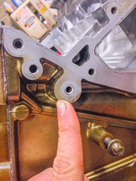

I bolted my m60 heads to my m62 block last night, and noticed something else. The m62 block has an oil passage that feeds the big timing chain U-guide for lubrication. The guide uses a small bushing with a pin hole to limit flow, as the oil passage hole is big (a bit over 3/16"). With the m60 timing chain setup, the U-guide is eliminated, and a sprocket takes it's place. The hole in the block is left uncovered. This is a passage directly connected to the oil pumps output. This is obviously a problem, I'm surprised that the few m60b44's out there running currently aren't having oil pressure issues.
I'm having a friend make a tapered brass plug that I'll pound in there to seal this up.
