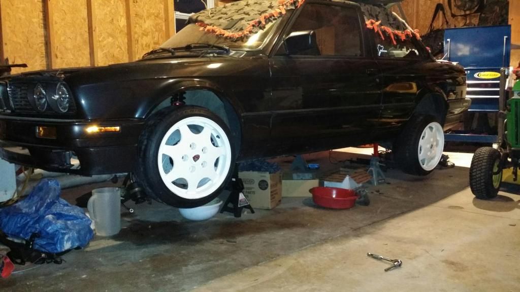

                    hello anyone reading this,
                    I am currently stuck on this problem
                    The car has grown wheels (back shocks not attached)
                    I still need to purchase
                    a diff
                    fab driveshaft
                    sway bars (since ireland engineering stinks)
                    radiator
                    suggestions welcome! thanks for reading!

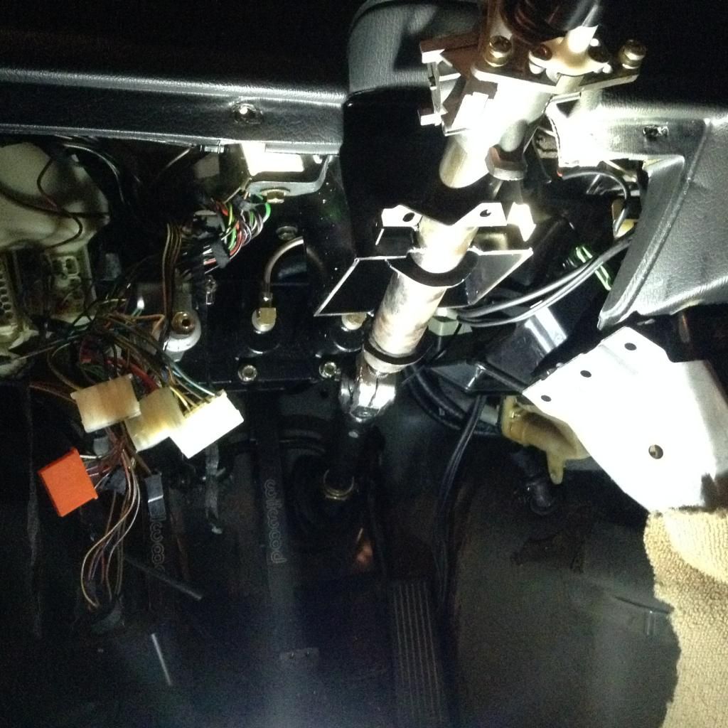

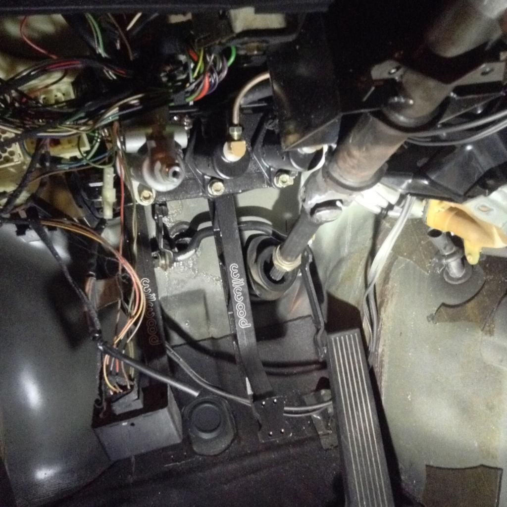

                              FINALLY after much monkeying around with the dag gone stock steering column that i was told would not work with the wilwood drop pedal box, I've gotten it to fit after making some adjustments and welding a bracket to it.

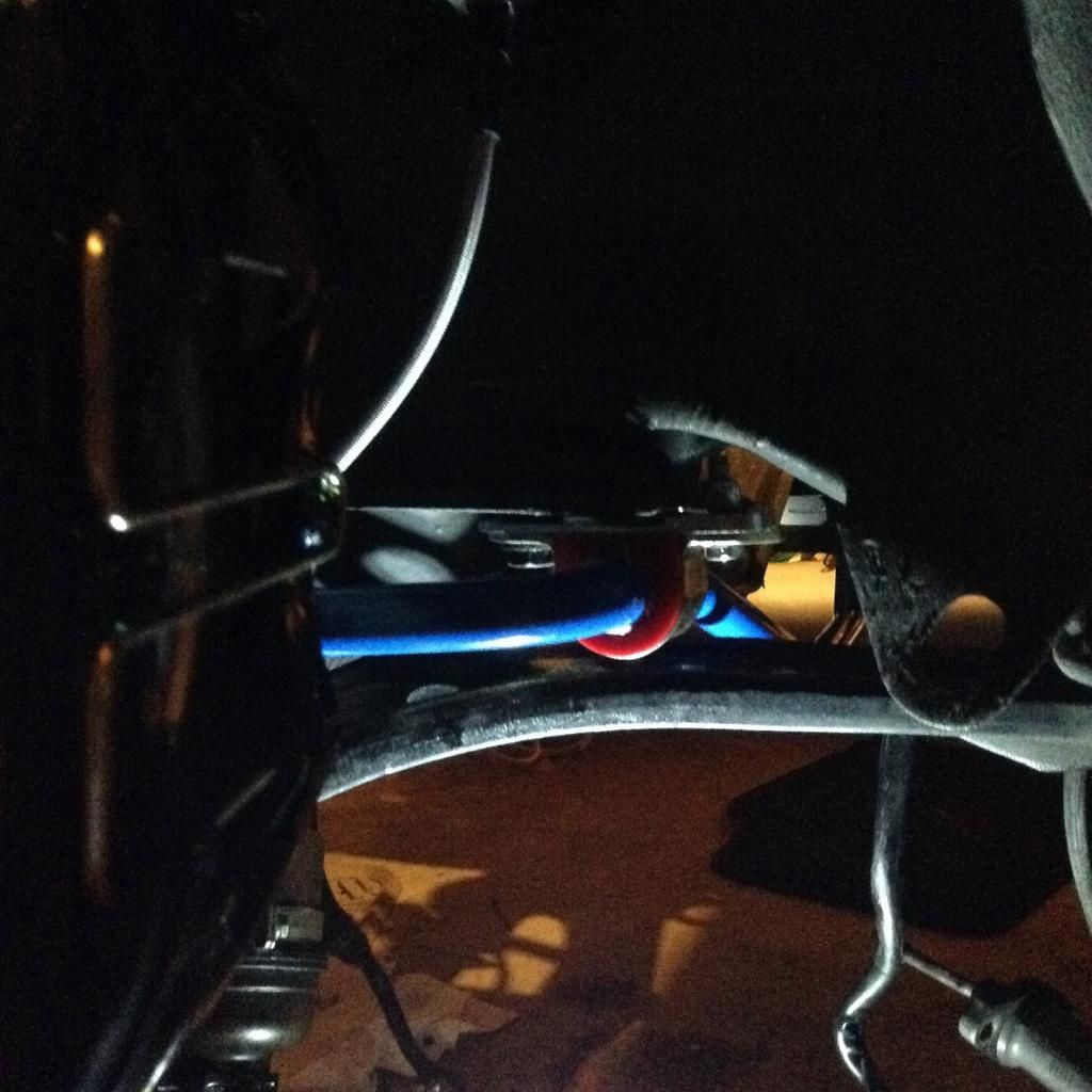

                              in the midst of installing IE bars but get this, the rear has a bracket that needs to be drilled into the rear trunk area. who knew?

                                Also, dem brakes
