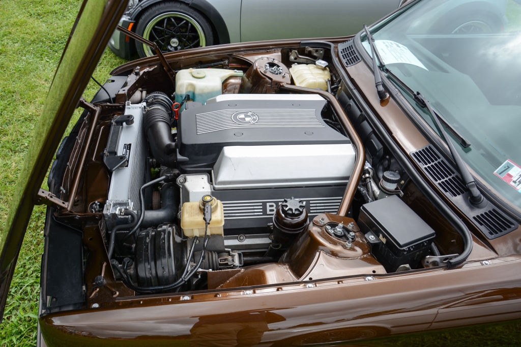

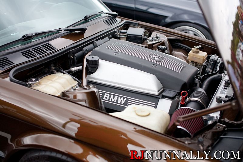

    I 'upgraded' to the m62 cover when I built my m60b44, and definitely prefer it. Sometimes the buttons are a bit sticky and can be a PITA, but they are 15 years old...
    M60:
    M62:

      clean as F*CK!
