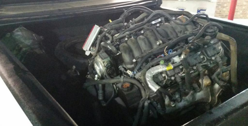

            Here are some before pics of the LS1 and T56. came with an SLP intake and I'll be looking into a custom radiator setup to try and run cold ram air through the kidneys bypassing the radiator by getting a short and thick dual pass or single pass triple core.

              here is the current LS1 teardown progress.
              finished the top end tear down last night. We finished pulling the wiring harness off the block and got the engine onto the stand then pulled the oil pan, sump, windage tray, cam and front cover.tomorrow we will continue tear down with the crank rods and pistons as well as the oil pump. hopefully we can pull the springs and valves on the headand then begin to clean up but it's not the night to the machine shop when they hot tank it.
