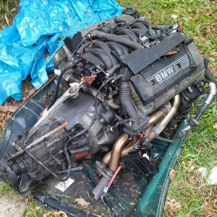

My new m62! bringing this thread back from the grave

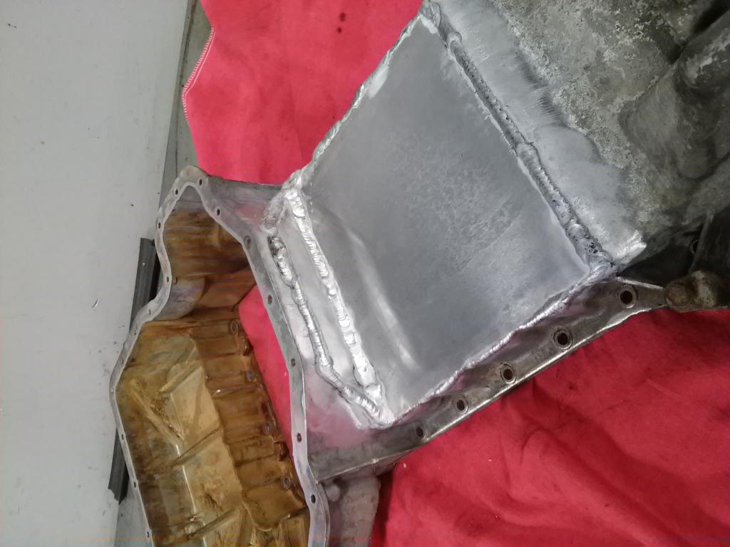

                            So some slow progress. I sent my oil pan out to jayfabwerks, he is the guy on here with the turbo m62 e36. He is in the process of shorting my oil pan. Im also getting the first headers he made for his swap.

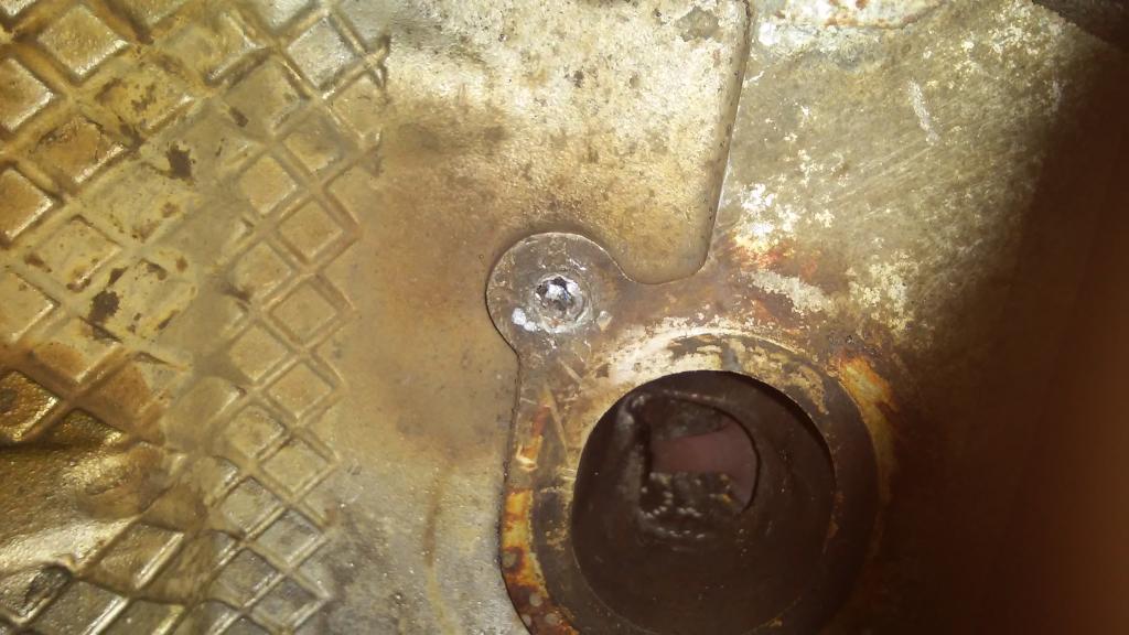

                            Also,while removing my old exhaust manifolds this happend...Click image for larger version
                            I tried to drill and extract the bolt, and the extractor broke inside... SOO my two options are m60b44..
                            Or pay 150$ to the machine shop to remove the broken stud and re surface the heads..
                            Any input would be helpful, maybe a poll to see what would be easier/ faster / cheapest?

                              :firehop:Some more updates, received my modified oil pan and some exhaust headers from jabfabwerks, or driftingminor913 on the forums. pretty happy with the out come. the welds are very solid, he also did it for a great price and only took about two weeks. hit him up if you need some welding done!

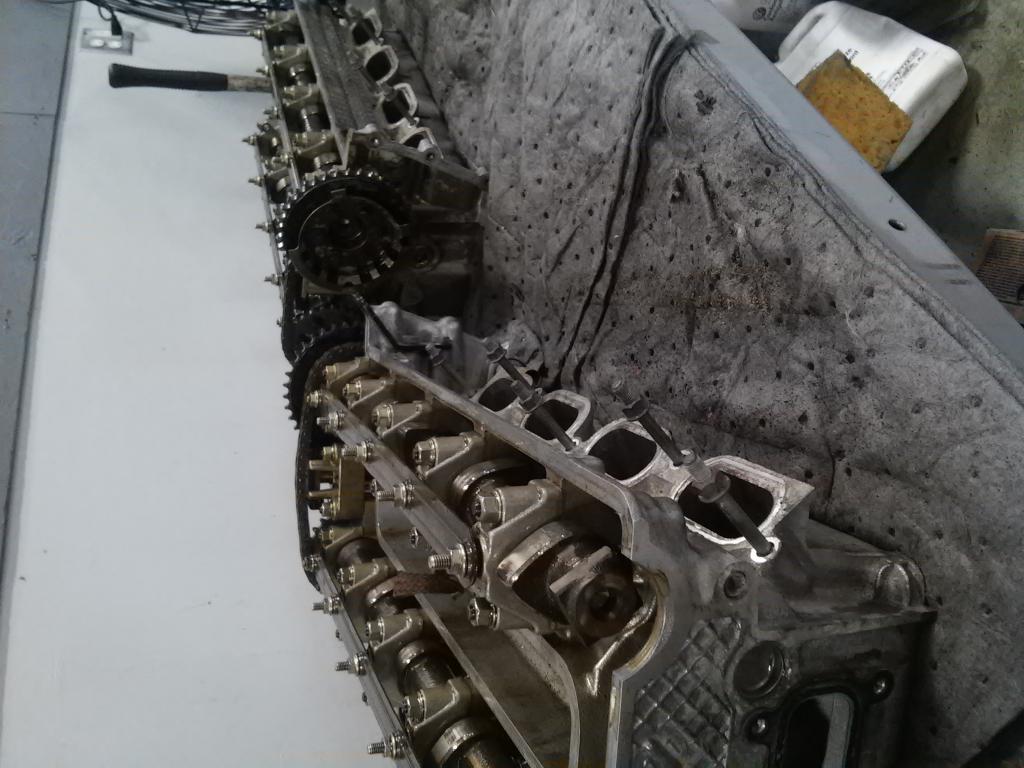

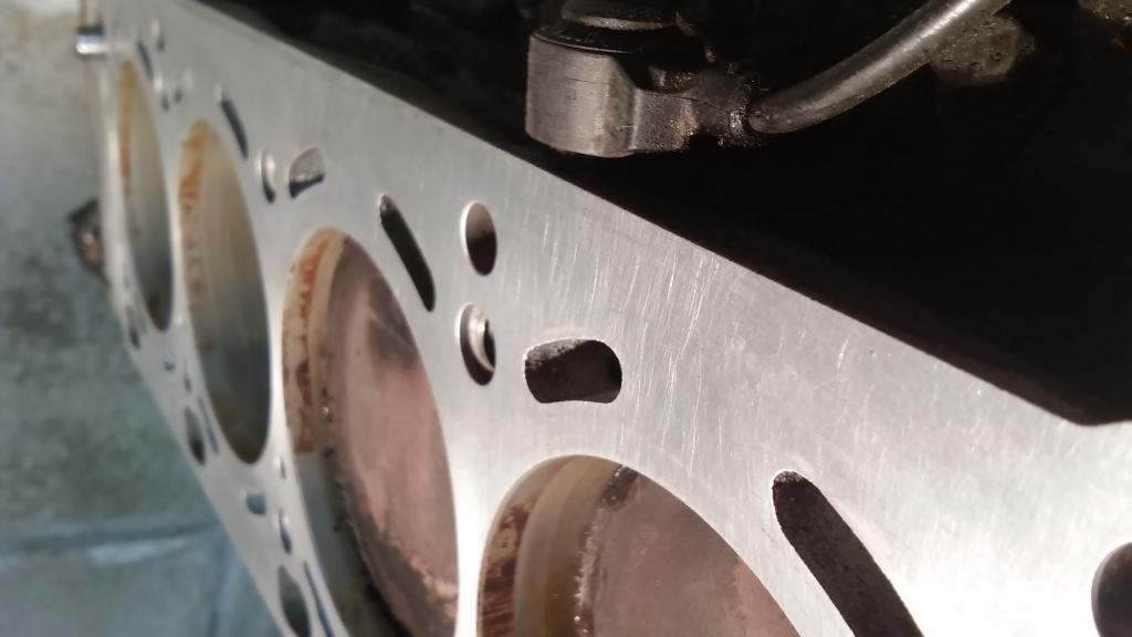

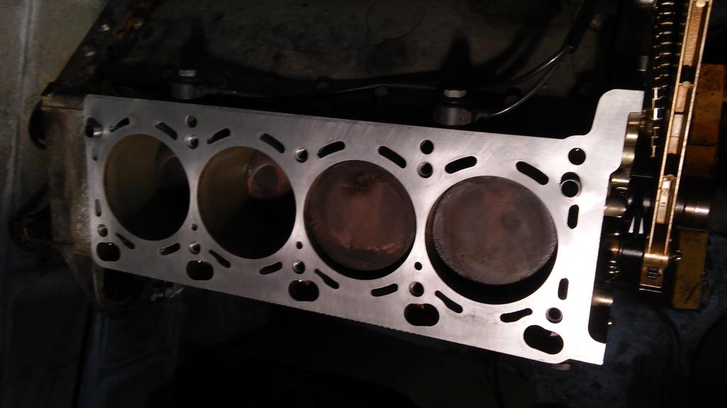

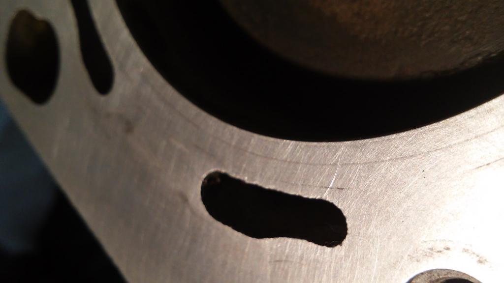

                                More updates! trying to keep the ball rolling. i removed both cylinder heads, and they are being resurfaced and the broken stud out as i type this. cleaned the block surfaces and prepped for the heads to come back.
                                as i was cleaning them i noticed all of these small black gasket lines, they are very hard to get off, does anyone think they will effect any sealing between the heads and block?
