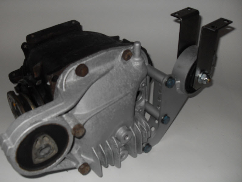

    LS1 rear diff dual ear
    I've been driving my swap for about 1 month now, and the car twists so hard under hard acceleration is scary...
    Anyway does anyone have a picture of Garret's differential mount installed on the car?
    I fitted the piece on the diff cover, but the two side pieces are kinda far from the boot floor. I know I have to put some pressure on the diff, should I try and get them to line up with the hole on original ear?
    Thanks

        Are your subframe+diff bushings completely shot or something? That's the only way I can see the diff shifting on a horizontal axis.
        Vertical though? I'd say it's probably flexing pretty good. If there's a gap between the new mount and the floor don't push the diff up to get it to touch - that's gonna change your pinion angle. Use a piece of aluminum/steel/rubber or something to take up the excess space, drill holes where necessary and boom you're good to go

                      E30 have a weakness in the construction,, ab
                      if you have a powerful engine ,, you will break the upper frame in the body where the diff bolts to the ear,,, this is well known on E46 M3,,, E36 M3 evo and on ALL Euro Z3 ///M roadsters,,,,,,,
                      i had S38B38 ,, and one day the car was almost sliding around to much,, when flooring and playing in corners,, the frame was broken ,, and we made a reconstruction to the ear,, another plate and welded the floor bottom in the trunk,, from under neath

                        • garretvs
                          • 464
                          You need one of these .....
                          E30-LS1 aka. 357is

                            I've heard of E30's starting to kill that body mount starting at about 300 RWHP. The dual mounting ear setup eliminates the problem.
                              Where can we get one of these?
