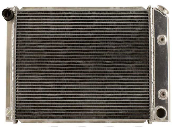

    Greetings form Vancouver WA. I have been looking to do a swap project for a while. I got started on my E30-LS2 a few weeks ago.
    Old M20 is out and bay is tidy. My car is an auto brilliantrot, my GVS kit is looking fine in it's shiny red powder coat finish.
    The dead Goat is (reportedly) low miles and I'm searching up parts. I hit a snag when looking for a radiator as JTR doesn't sell the one on it's website anymore.
    I'm looking for a replacement plastic / aluminum base Camaro rad with a single 1.25" core.
    V8 Swaps that work. Conversion Manuals and parts for V8 S10, Datzun Z V8, Datsun ZX, Jaguar V8, Astro Van V8, Chevy TPI & TBI, Chevy Colorado, Volvo 200 & 700.
    Any place you can think of ? Ive been looking for a few days.

    LS cooling comes out both passenger's side FYI. Or I guess you were posting up that rad for size?
    I have a mishi dual pass race radiator.

      Anything decent on Summit or Speedway?
      Griffen could make you a custom one...

        The radiator used as a top left inlet bottom right outlet. I need to find a radiator that will mount with the GVS mounts.I'm going to try to follow Garrett 's instructions as best as I can because my goal is to get this done before the end of summer, with a/c !

          Try this one:
          https://www.radiatorexpress.com/prod...Fc2TfgodXloAZw
          It will work with our radiator brackets as long as the maximum thickness of the flange on the end cap header tanks is not more than 2.6"
          You need a relatively thin (2.6" or less) radiator so that there is room for the SPAL puller fan on the back side of the radiator. Also, the outlet at the bottom of the RH header tank does not interfere with the pulley on the A/C compressor on the LS engines.

            Thanks for the reply Garret. I will check out that rad since I haven't found much else. Can the radiators' built in cooler be used for anything ?

                      You could just go with a factory e36 rad or one from mishimoto. I'm running a factory e36, which would be a drop in for your late model, and have no issues keeping the temps down.
