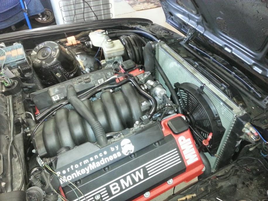

    Ok so I have been prof'ing out my build and at this point I only have one issue/ problem i need to solve.
    I am currently running a E28 535i radiator. This rad came with two thermal switches on the rad stock.
    I was doing some heat cycling of the cooling system.
    when manually switching on the fans it keeps the motor nice and stable.
    My issue is that the thermal switches are not turning on the fans. The system works and works well but I can't seem to get the thermal switches in the rad to react to the heat and switch on. I'm running in-line relays so the switches are not pulling a load.
    I have my small puller fan on the low temp switch and my big pusher fan on the high temp switch.
    I'm just looking to see what you guys are doing. I was thinking of using block/ motor mounted thermal switches but I'm not sure where I wound tap in two run to switches?
    I'm also interested in knowing what temp you have your fans switching on?
    thanks for you input

      well i switched to two new thermal switches.
      low temp went from 91* to 88*
      and the stayed with 99* with the high speed but went with a new one.
      also have my large pusher setup on the low temp switch and my smaller puller on the higher temp switch.
      Large pusher!
      Small puller!

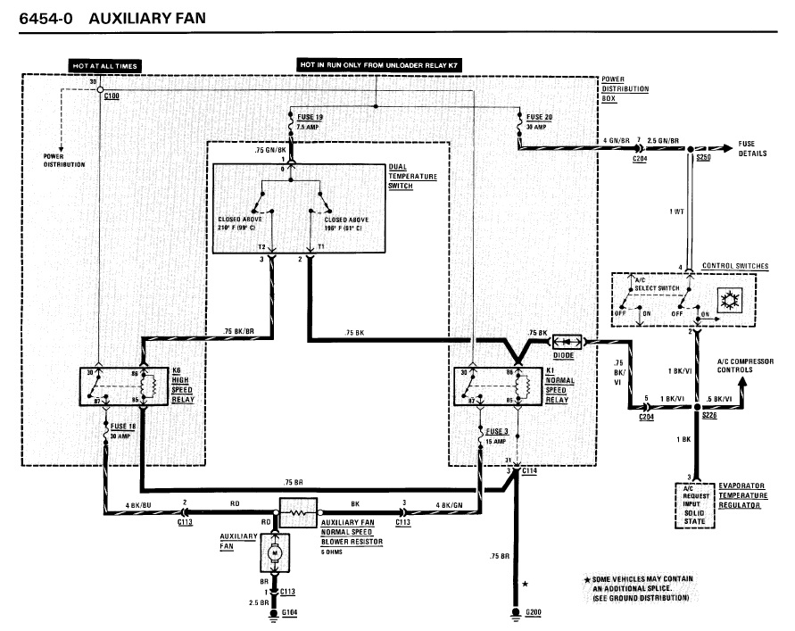

              • JGood
                • Jan 2004
                • 7959
                The stock fan switch/relay system is more then adequate, I'd figure out what's wrong with it before installing some aftermarket junk.
                Is your switch engaging at the specified temp? You should have continuity across the pins. You can test it in a pot of water. If not, that's a problem, you have a bad switch. If it does work, then your wiring is wrong.
                What do you mean you're "using that as a ground from your relay"? The stock e30 aux fan switch is power to the relay, not ground.
                Fuse 19 should feed power to both of your fan switch inputs. You low temp switch output should be wired to the normal speed relay pin 86. The K1 (normal speed) relay pin 85 should go to ground. Normal speed relay pin 30 should be constant power, and pin 87 should go to fuse 3 (15 amp), then to the fan (through the fan resistor on a stock setup). Similar setup for the high speed relay.
