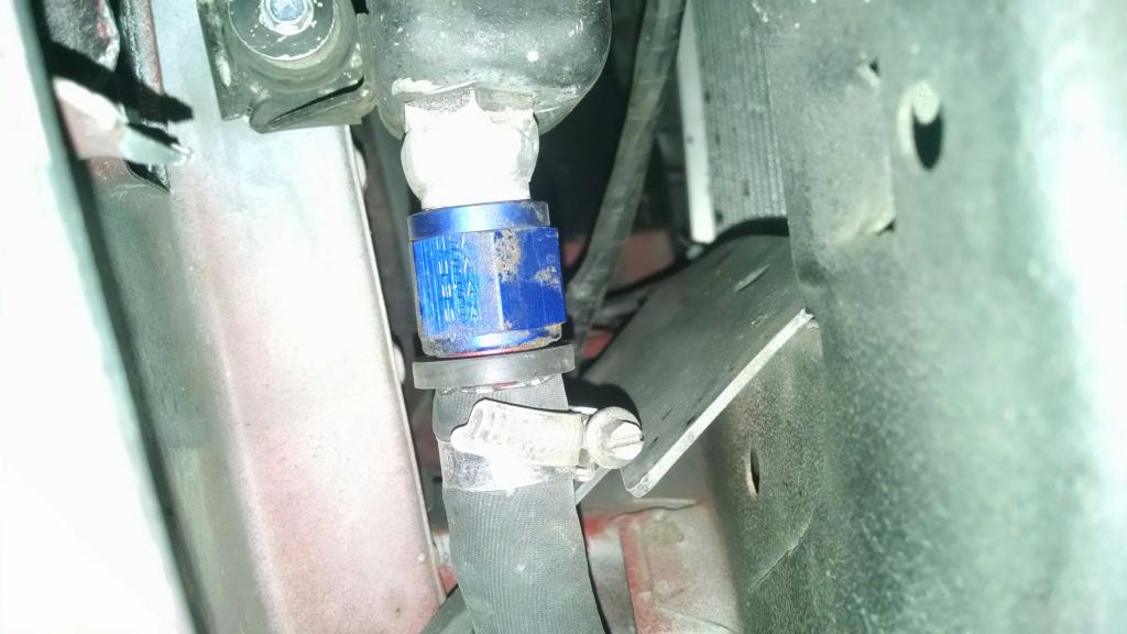

                    I cut the factory ends off the oil cooler and welded on fittings. I relocated my oil filter to the area behind passenger headlight. Click image for larger version
                    Sent from my XT1080 using Tapatalk
                    89 e30 M60B40 6spd
