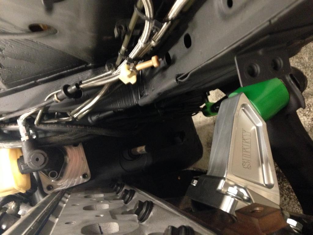

              #51
              Sorry for ginormous pic..

                #52
                How's your pedal feel? I forgot I did the swap and almost missed a corner on my first lap at the track yesterday lol. I need to find a smaller master or something.
                Status: HG repair. 488wtq though!
                  #53
                  Its heavy but usable and consistent. I just need to get used to it
