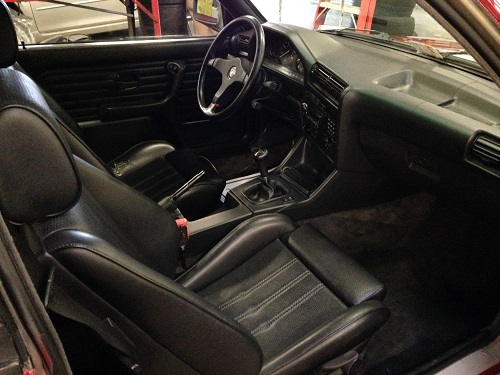

    The interior...

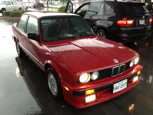

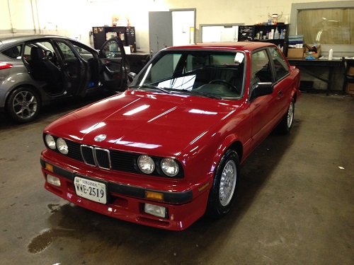

            Out getting familiar with the E30, also decided to meet my Buddy Kevin for lunch. He's also a LS junkie and has been instrumental with my V8 101 crash course. Here is his G8.
            [ATTACH]106350[/ATTACH]
            Even though shes 20 years the elder, the E30 still looks good!
            [ATTACH]106349[/ATTACH]

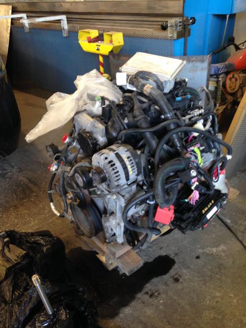

              After careful consideration, I have decided to go with the LM7 5.3 LS truck motor. Before the hate gets spewed from all the keyboard know it all's, I went with this motor because of availability, price, strength of iron block for forced induction and did I mention Price & Availability? After being stood up on two different LS1 for sale adds and being quoted outrageous prices, I scored this bad boy for only $300 bucks
              Spec's on motor:
              2006 LM7 from a Chevy Silverado 1500
              5.3 Iron Block
              295 hp and 335 lb·ft of torque
              76k Miles
              Price: $300 w/ $75 core charge Delivered

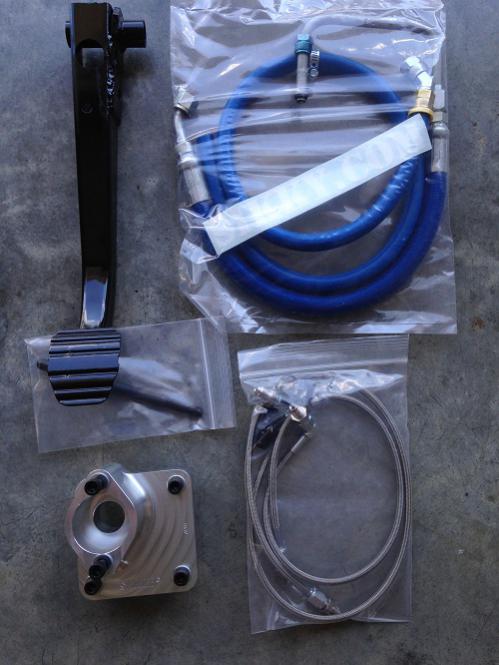

                Up to this point, I'm extremely satisfied with all the Sikky products, packaging, craftsmanship, shipping and customer service. Take a look for yourself...
                Hydroboost Delete Kit & Power Steering Lines
                Hydroboost Delete Mount

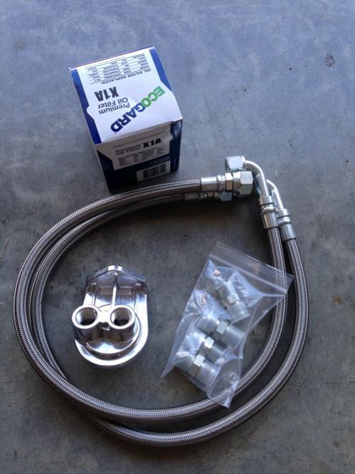

                Oil Relocation Mounting Kit

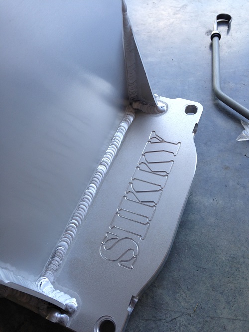

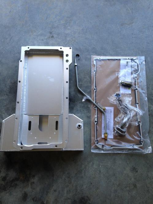

                Aluminum Oil Pan
                Aluminum Oil Pan
                The parts speak for themselves :D:D

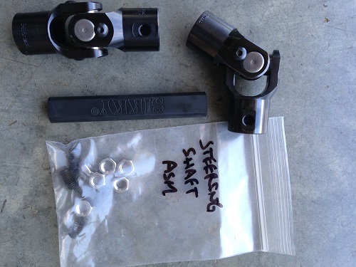

                  E30/36 Steering Shaft

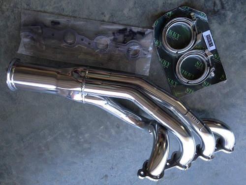

                  1 7/8 Headers

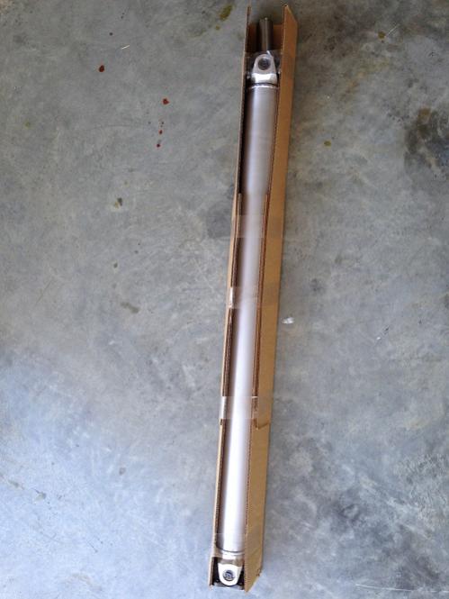

                  Aluminum Drive Shaft

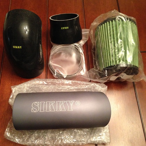

                      Lastly, the LS Air Intake kit rounds up the rest of the Sikky products. At this time..... ;)

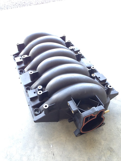

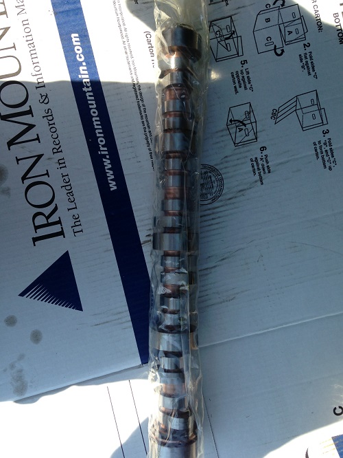

                          Okay, so for those of you not familiar with the LM7. Its a 5.3 Iron Block version of the LS lineup. At roughly $1600-$2000 cheaper than a LS1. Based on HP per dollar, the 5.3 is 10x better. Also, if you plan to run forced induction, the iron block is a great platform. To each their own but the LM7 has 295 hp and 335 lb·ft of torque which isn't to shabby for a starting point.
                          Here are a few goodies to spruce up the motor and create some more power out of the 5.3 LM7
                          Used LS1 Throttle Body attached to a LS6 Intake
                          LS6 Intake

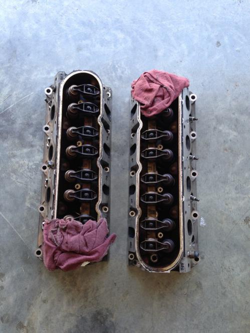

                          Used 243 Heads

                          Tick Performance Mild-Cam

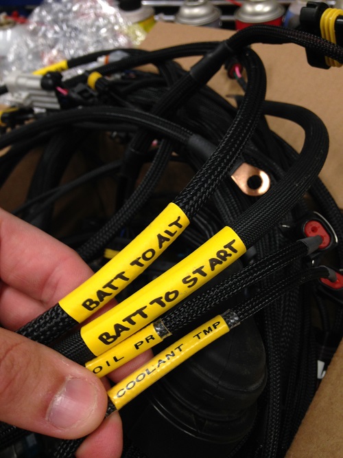

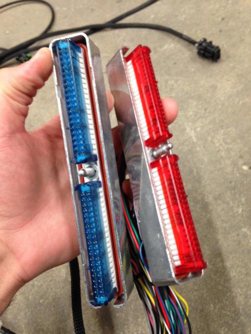

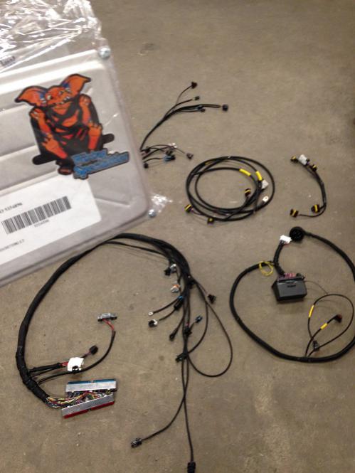

                            I had the Heads sent out to Harman's in Roanoke City, he is a old school Hot Rod guy with a great reputation with the older community. He came highly recommended and works the heads by hand prior to rebuilding them. During the three week wait, I went ahead and contacted Yury at Wiring Specialties. After some research and several conversations I ordered the Pro-Series Complete Harness for the LSE30. Not cheap but nothing worth it is right?
                            Harness Specs:
                            Wiring Specialties Pro-Series
                            New PCM with Tune
                            Coolant & Oil Gauge Adapters
                            GM Compressor Adapter
                            LS1 Coilpacks
                            LS1 F-Body o2 Sensor
                            Grounding Kit
                            EV1 Injector Type
                            Price: $1275 Delivered
                            Kit can be found here.. http://www.wiringspecialties.com/ls1tobmwe30w.html
                            SWAP METER: $11,643 & climbing fast....
