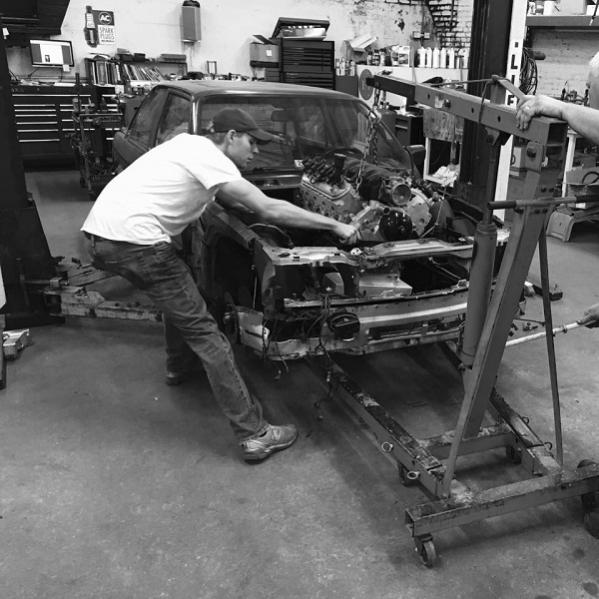

        :nice: lol So this is when we figured out the motor mounts were upside down. Motor went in and looked like is was meant to be there. The headers made it so tight, had to remove them prior to fitting the motor. We were able to install the passenger side from the top but the drivers side had to go in from under the car.
        **Side Note** Be sure to bang out the firewall as directed in the Sikky manual then, bang it out some more. Once you think your done and have plenty of clearance.....bang it out a little more. Trust me!

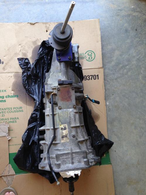

        The Spec Stage 2 clutch that came with the T56 is shot, plate is warped and the teeth are jacked up. Looks like i'll be researching clutches, I know most guys like to run the Z06/LS7 setup but I also hear horror stories about pedal feel and chatter.. Kind of bummed I need to spend more on this, It is what it is.
        After a few days and several phone calls, I have some parts on order.
        -New Clutch
        -New Shifter
        Decided to ditch the B&M shifter while I was at it..

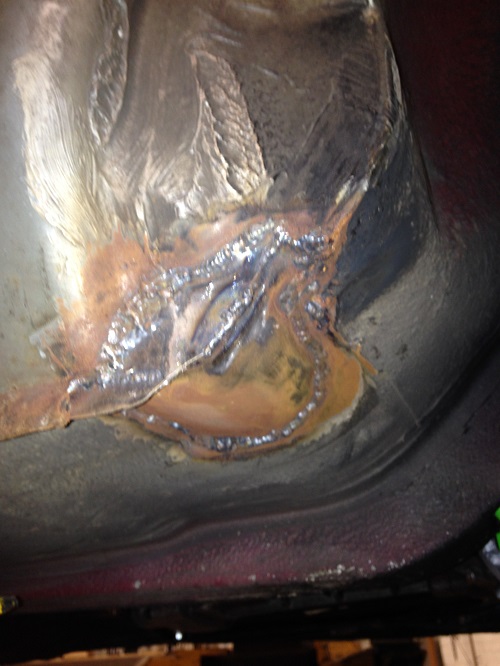

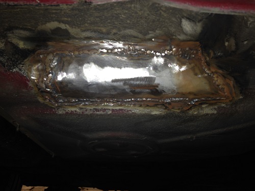

                            RUST REPAIR SUCKS!
                            My brain was fried building "online carts" adding dollars and pinching pennies. I took a break and made it a mission to complete the rust repair. After about 8 hours, we cut out a few problem areas and patched the hole. Again, more amateur welding, don't judge me, at least the rust is gone. Once coated and parts are installed, can't see anything anyway.
