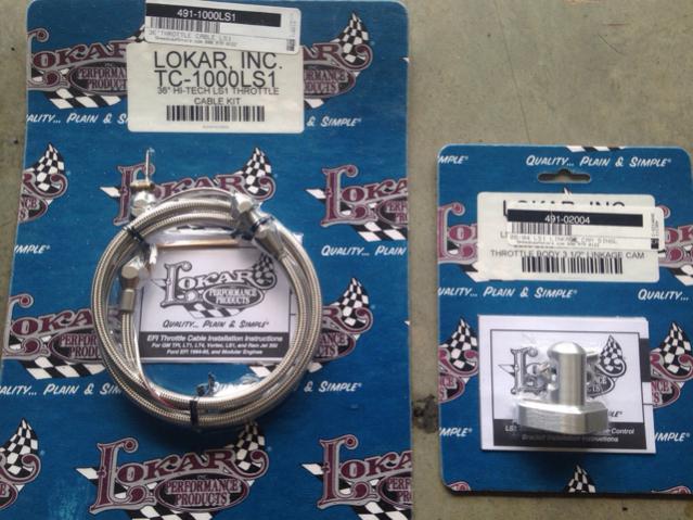

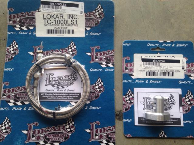

                How long was your throttle cable? I need to get one
                e30Ls1 Swap IG: 1dirty30
                • E30Whore
                  • Mar 2016
                  • 183
                  #203
                  Not Another Cheap V8 Swap...
                  Rey, I will send you more info via Facebook man. This is the kit tho.
