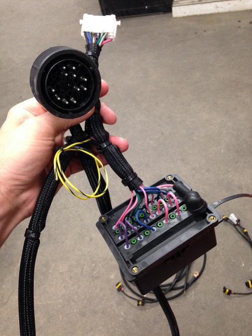

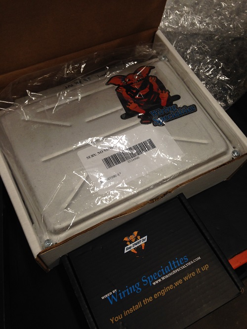

I had the Heads sent out to Harman's in Roanoke City, he is a old school Hot Rod guy with a great reputation with the older community. He came highly recommended and works the heads by hand prior to rebuilding them. During the three week wait, I went ahead and contacted Yury at Wiring Specialties. After some research and several conversations I ordered the Pro-Series Complete Harness for the LSE30. Not cheap but nothing worth it is right?
Harness Specs:
Wiring Specialties Pro-Series
New PCM with Tune
Coolant & Oil Gauge Adapters
GM Compressor Adapter
LS1 Coilpacks
LS1 F-Body o2 Sensor
Grounding Kit
EV1 Injector Type
Price: $1275 Delivered
Kit can be found here.. http://www.wiringspecialties.com/ls1tobmwe30w.html

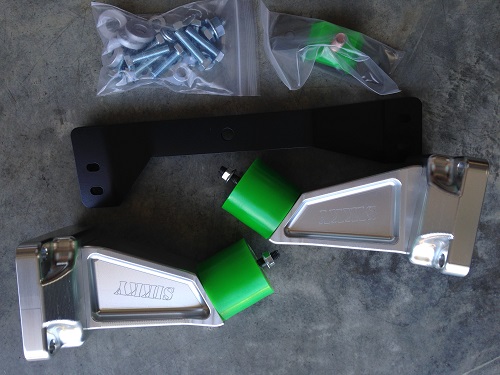

Up to this point, I'm extremely satisfied with all the Sikky products, packaging, craftsmanship, shipping and customer service. Take a look for yourself...
Hydroboost Delete Kit & Power Steering Lines
Hydroboost Delete Mount
Oil Relocation Mounting Kit
Aluminum Oil Pan
Aluminum Oil Pan
The parts speak for themselves :D:DLeave a comment:
