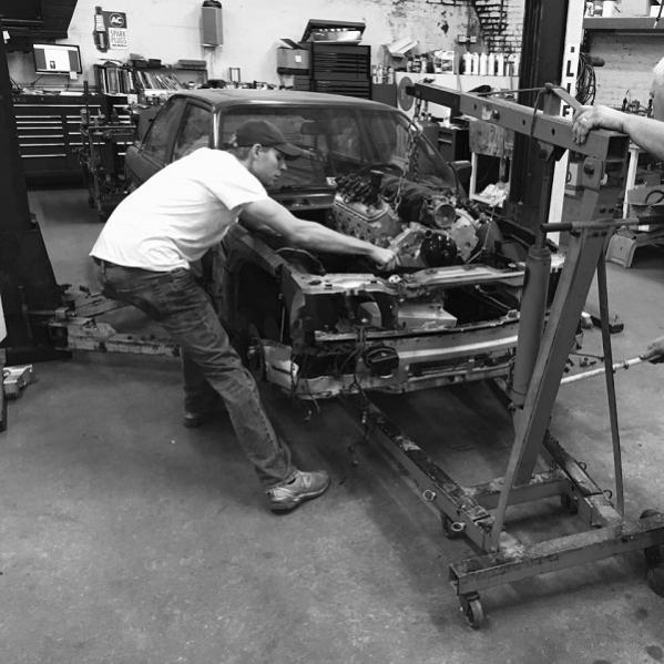

:nice: lol So this is when we figured out the motor mounts were upside down. Motor went in and looked like is was meant to be there. The headers made it so tight, had to remove them prior to fitting the motor. We were able to install the passenger side from the top but the drivers side had to go in from under the car.
**Side Note** Be sure to bang out the firewall as directed in the Sikky manual then, bang it out some more. Once you think your done and have plenty of clearance.....bang it out a little more. Trust me!

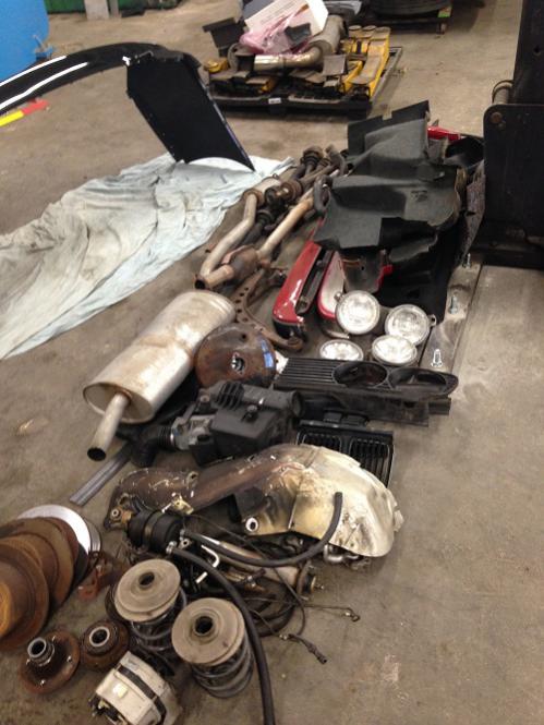

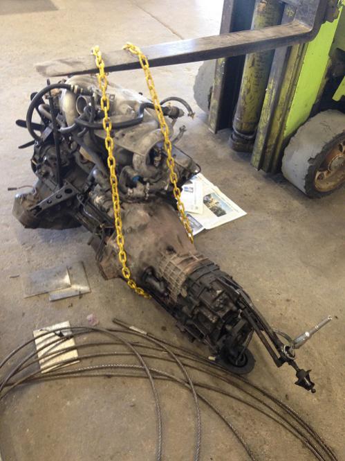

We got everything broken down and pulled from the LM7. I'm trying to salvage what I can use and organizing what I have in attempt to see whats still needed..
After fooling with the motor for a few hours, we prepped the E30 for surgery. Out comes the BMW M20 and transmission for the last time...
Maybe ahead of the game but decided to go ahead and strip out a bunch of dead weight or things that will be getting replaced later on. Now's a good time to really inspect the chassis and condition of the under body, fender-wells and body of the car. A few problem areas have arose but more on that later...
Now, time to spend a Saturday cleaning these parts up, snapping a few pictures and listing them on Facebook to sell. Need to recoup some cash asap!Leave a comment:
