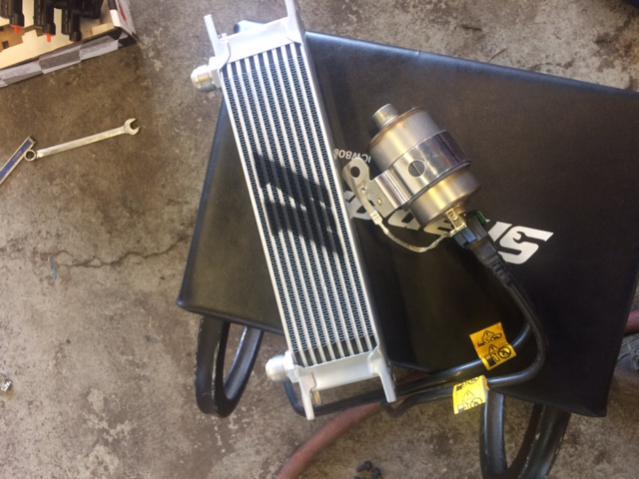

Universal 10 Row Oil Cooler from Mishimoto and a FPR from a C5 vette, my brother used this in his LS1 Chevelle and it was very cheap compared to the aeromotive and other name brand FPR’s.

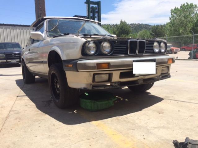

Starting disassembly.
Pulling the motor, for my first engine pull only breaking the cruise control is pretty good by my standards.

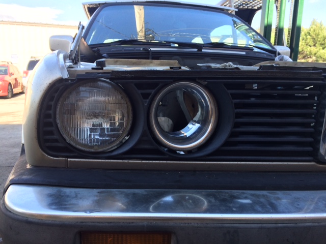

Pulled the headlight for a cold air intake, I think the chrome really matches the diving boards.

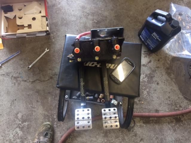

Some more parts, Garagistic Booster delete bracket with Wilwood pedals and master cylinders.

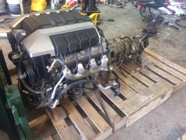

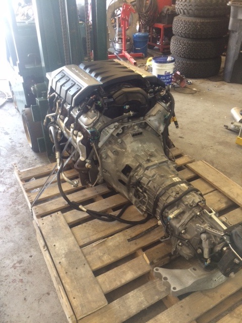

I ordered this LS3 and tranny off of Ebay. The transmission is a TR6060 so that makes shifter location and drive shaft a little more difficult. The quick fix is ordering some adaptors, custom driveshaft, and welding the shifter to fit through the stock hole.
After inspecting the motor and tranny the only things that were broken were a few miscellaneous connectors and sensors, nothing I shouldn't be able to find in the local junkyard.

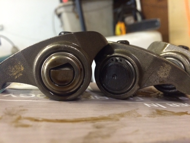

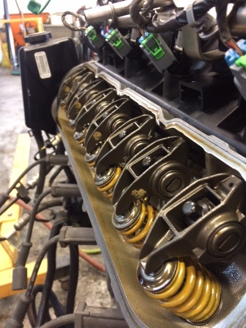

My first order of business was a trunion upgrade just for some peace of mind, it was really easy with a press.
Comparison of stock rockers and upgraded ones
