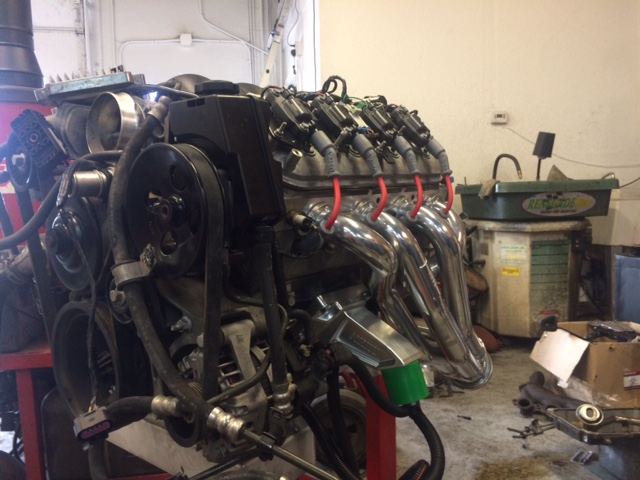

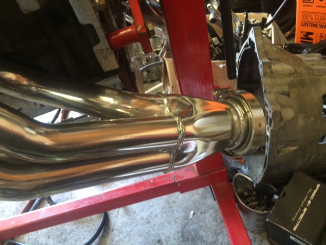

    I had to special order a Sikky Kit without the driveshaft and here are the 1 ¾ headers on the motor with the new MSD wires.

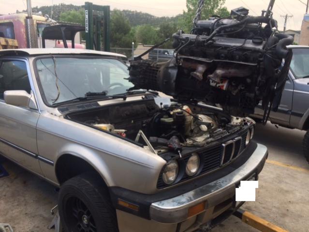

    Pulling the motor, for my first engine pull only breaking the cruise control is pretty good by my standards.

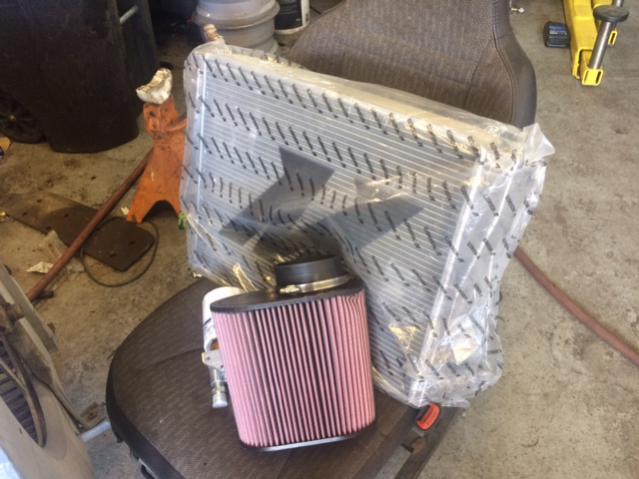

    Mishimoto Z3 Radiator and the HUGE K&N filter, I might have some space issues trying to fit that in.

      • Pootis
        • 636
        Damn going all out with the LS3 I like it. Are the headers Sikky sent you the new style or old. Might post a pic of the ends to make sure you don't have to modify them

        • beggs
          • Oct 2015
          • 52
          Ill have to snap a pic later, but where can I find more info on this? did a quick search and couldn't find anything.
          • Pootis
            • 636
            1989 325i LS Swap (Money Pit):https://www.r3vlimited.com/board/sho...d.php?t=244933
            COTM Feb 2019: https://www.r3vlimited.com/board/sho...d.php?t=428404
            • beggs
              • Oct 2015
              • 52
              Thanks for the info! I'm pretty sure I have the revised version but I'll have to make sure.

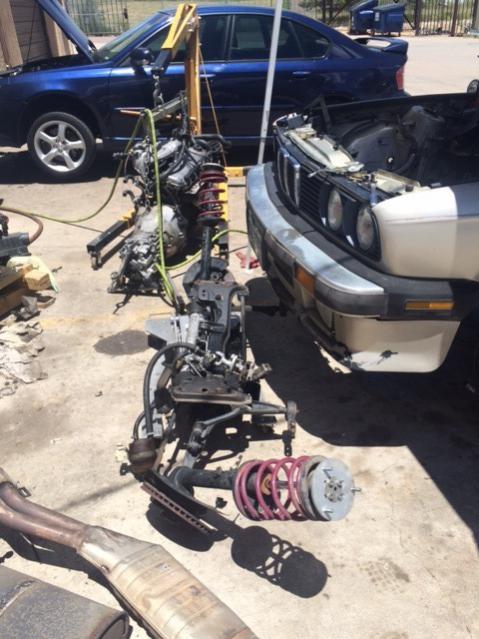

                  Today I dropped the front subframe, I am going to drop the car onto the engine like ultimateracing335i did in his LS3 swap. This will make everything much easier and smoother.

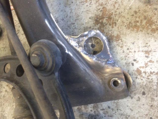

                  Tomorrow I'll weld on the Garagistic Reinforcement Kit I just got in the mail.

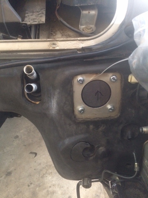

                      Today, we made a bracket for the hole the brake booster left.
                      Here is the finished product.

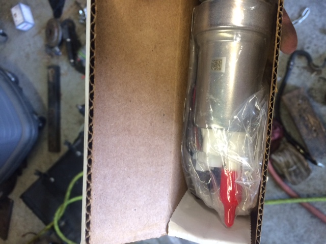

                      Also, I received this Walbro 450 in the mail! and I got the good news that the UUC Brake Kit finally shipped. I should be receiving that soon.

                        I also welded on those Chassis Reinforcements on the front subframe.

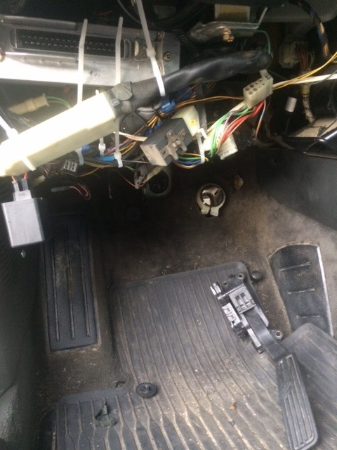

                        Removed the Steering Column so working on the pedals is much easier. I zip tied the rats nest of wires to help with that too. Also here is the stock Camaro hanging gas pedal. Different than the E30 floor mounted one. Anyone done this? Curious to see as too how you mounted it.
