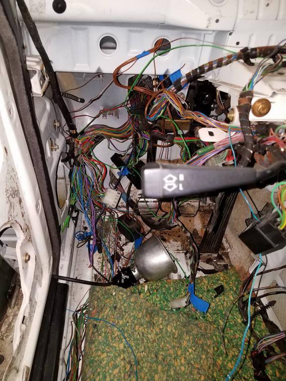

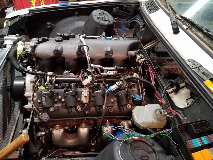

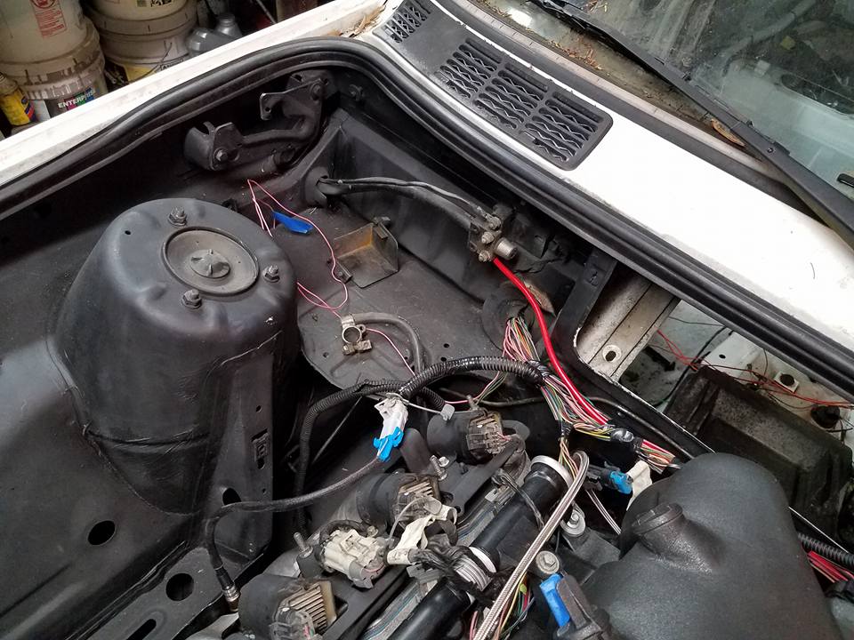

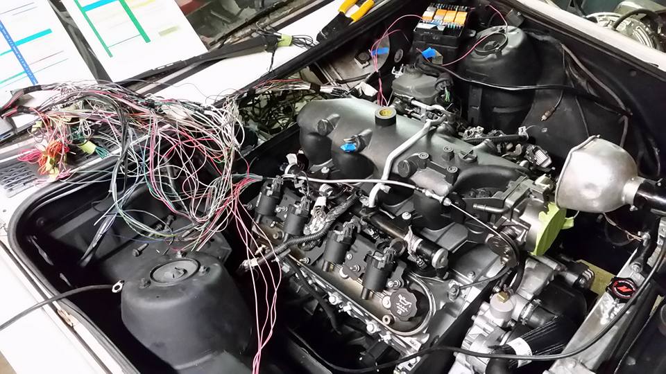

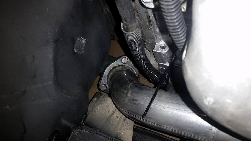

Worked on the wiring some more this weekend. The harness is installed on the engine and in the car. Next step is to integrate the engine harness with the car's harness.

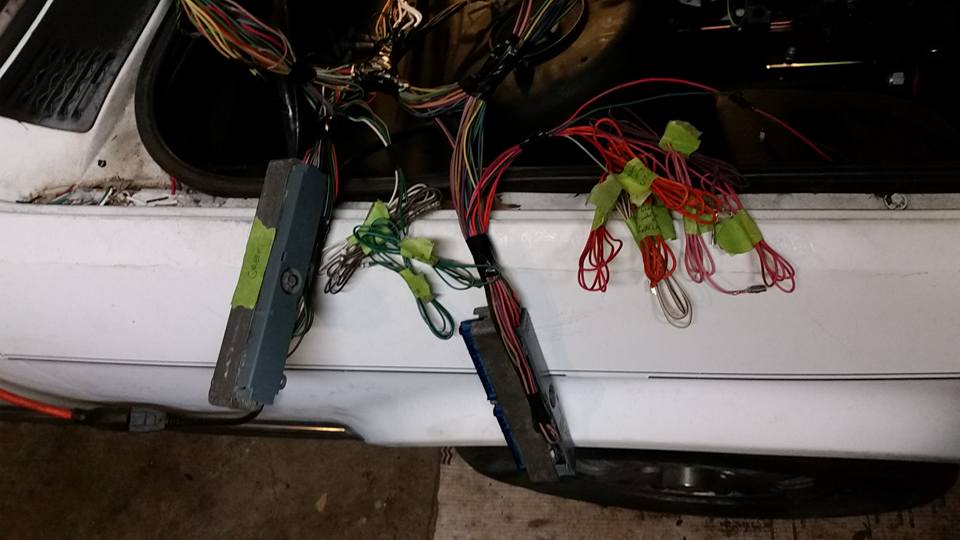

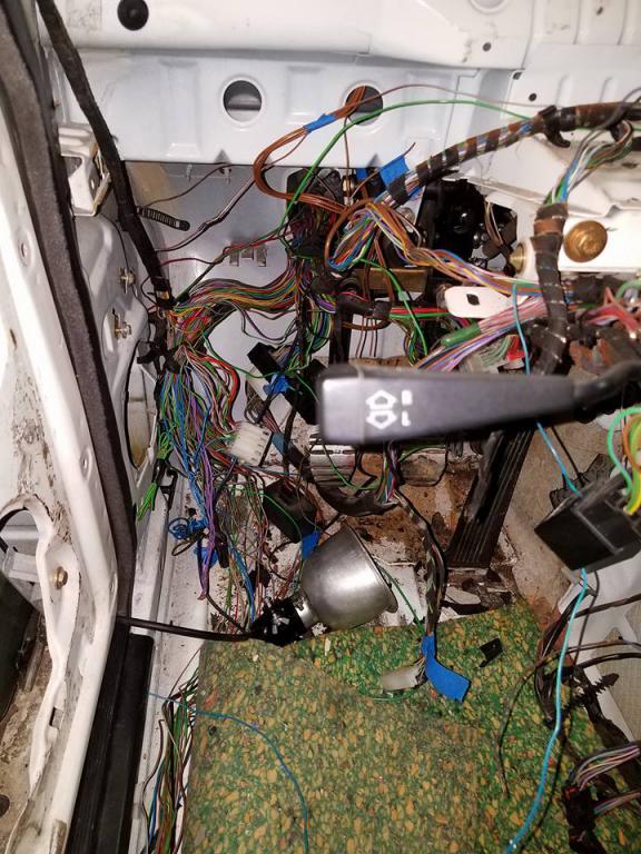

I had to extend all the wires coming from the driver side since the computer will be located on the passenger side.
All the connections needed were bundled together and separated

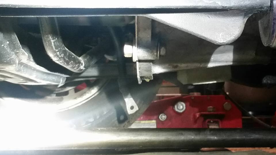

While running the harness to the trans, I noticed that there was brake fluid dripping from the bell housing.
Looks like I'll be pulling everything back out. :down:
