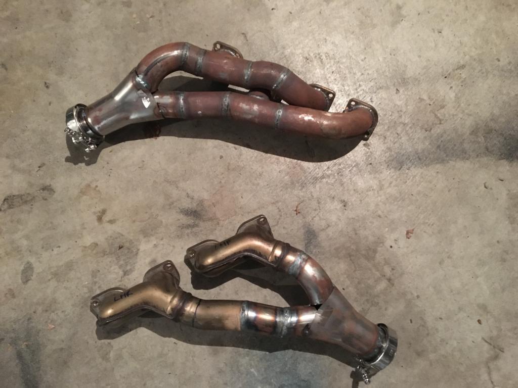

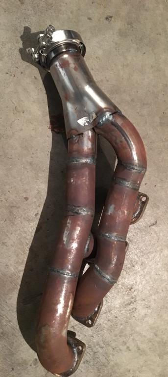

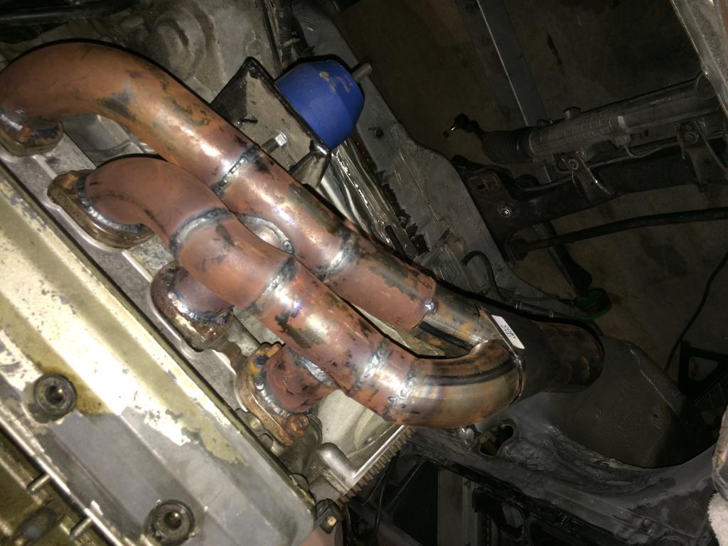

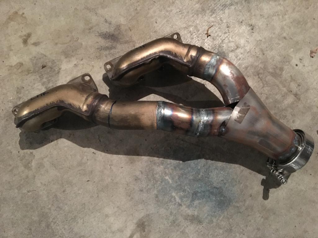

          Yeah manifolds are a big headache. I used the factory manifolds and cut and joined them higher up on the passenger side and had to make a whole new manifold for the drivers side, clearance on the steering shaft is very tight, changed shaft to a DD shaft and some flaming river universal joints for it to clear but still very tight.
          The booster was a kit i bought from ergen motorsport, you can use the factory booster with their bracket but i chose to use their mini booster and matching master cylinder, the glovebox becomes unusable once you start chopping it up, the reservoir i order some elbows and res from a 2002 and got a good length of factory BMW clutch res line to redo them.
          I also had to shave the alternator casing a little to clearance the frame rail a little bit.
          I found some pics of the manifolds, i hope these help.
          If there's anything else i can help with PM me and ill do my best to help you out

            Thanks a lot my friend those pics gave me confidence, once i got off work I did the passenger side manifold in an hour cutting and tacking, It fits perfect.
            Once I getting my steering shaft I will attempt the driver side.
            Cheers.
