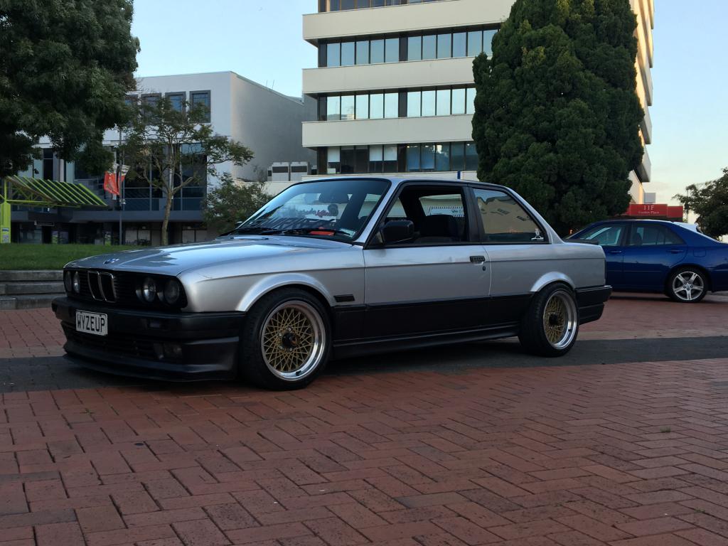

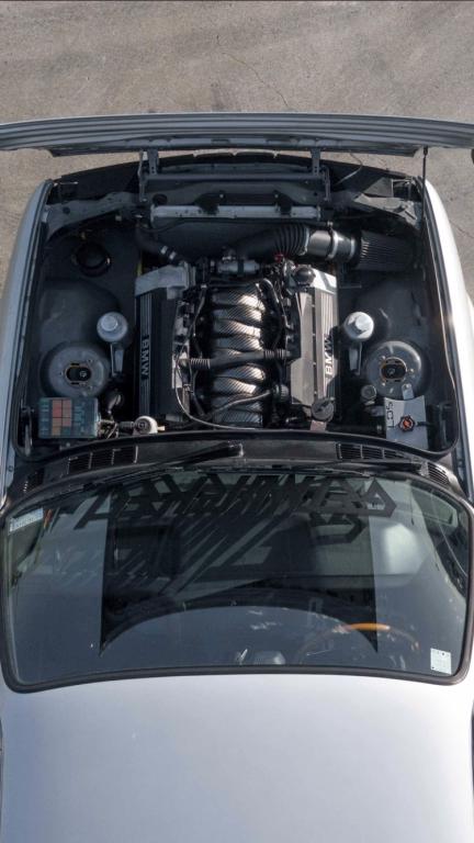

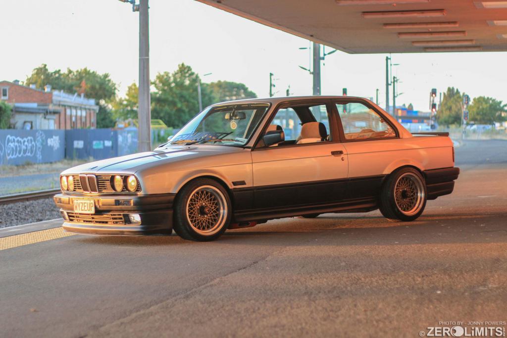

                    Its been a little while but have finally got a bit to update.
                    While waiting for the last few parts to be built i have been working on the interior, got hold of a iS rear seat covering and re-trimmed it/adapted it to how i wanted my interior to look, have also order some more of the same material to match the front seats and sub box, bootlid cover.
                    Finalised the exhaust after the first attemp was way too loud for our legal requirements here in new zealand so have had to add to 14inch resonators the the exhaust to quieten it down, unfortunately that means there is not a lot of clearance under the car so woll have to raise it up some now and fit more suitable tyres. grrrrrr.
                    Have had custom washer and power steering tanks built and installed in the vehicle, also had a custom expansion tank built which sits i n the battery tray, unfortunately still needs some work to fit correctly, so i am still to test the coolant system.
                    But, the car finally left the garage under its own power!!!!! soo stoked that it all works, clutch works, brake system works, it does a skid, very happy just a few little things to button up and it should be good to drive on the road soon :D
                    Unfortunately it wont stay at this height and will have to look into a more suitable/bigger tyre size to give me more ground clearance, FML!!!

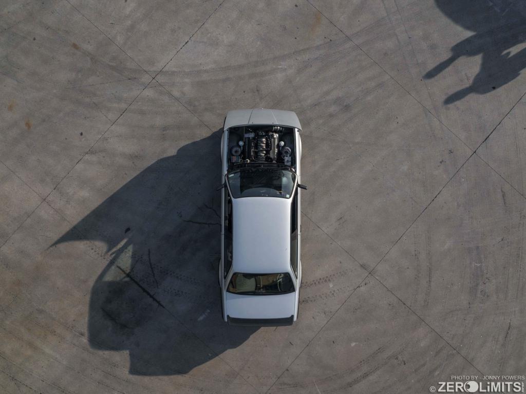

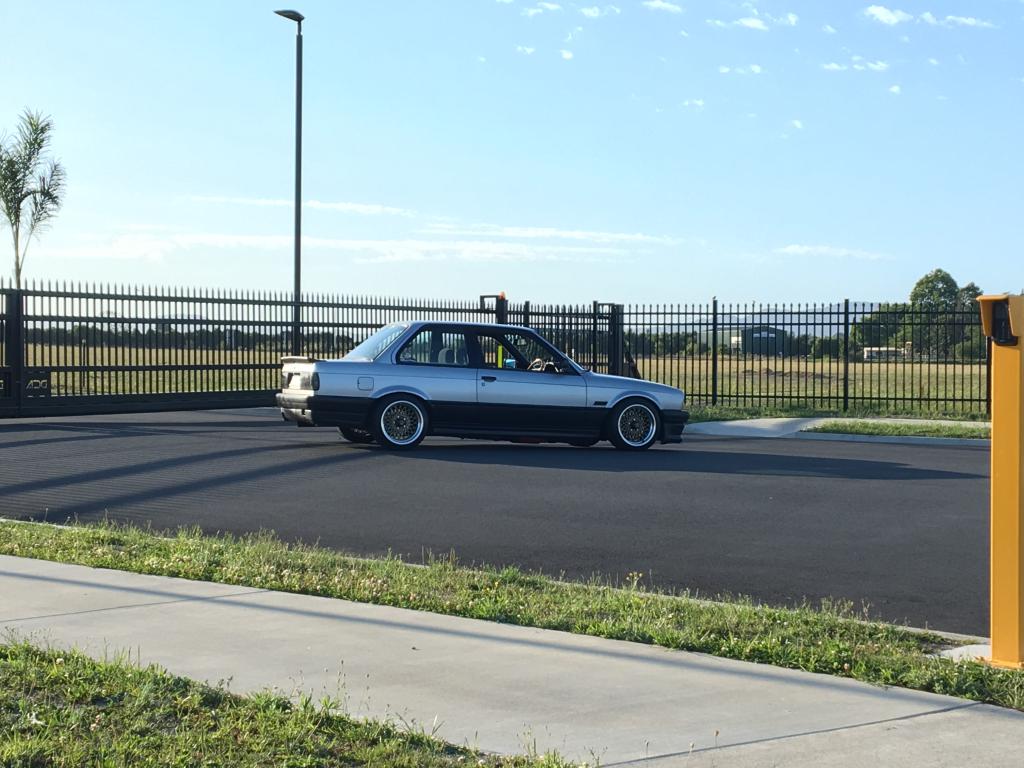

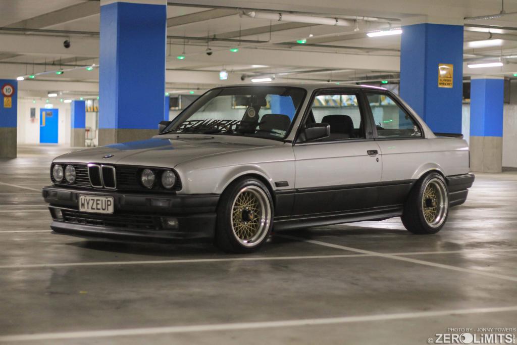

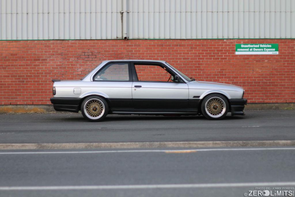

                        So its finally finished!!! Such a awesome car to drive. That sound and the ability to just cruise but when you give it some stick WOW does it boogey, after almost 3 years its been worth the build and time. I couldnt be happier!!!
                          #42
                          a couple of aerial shots
