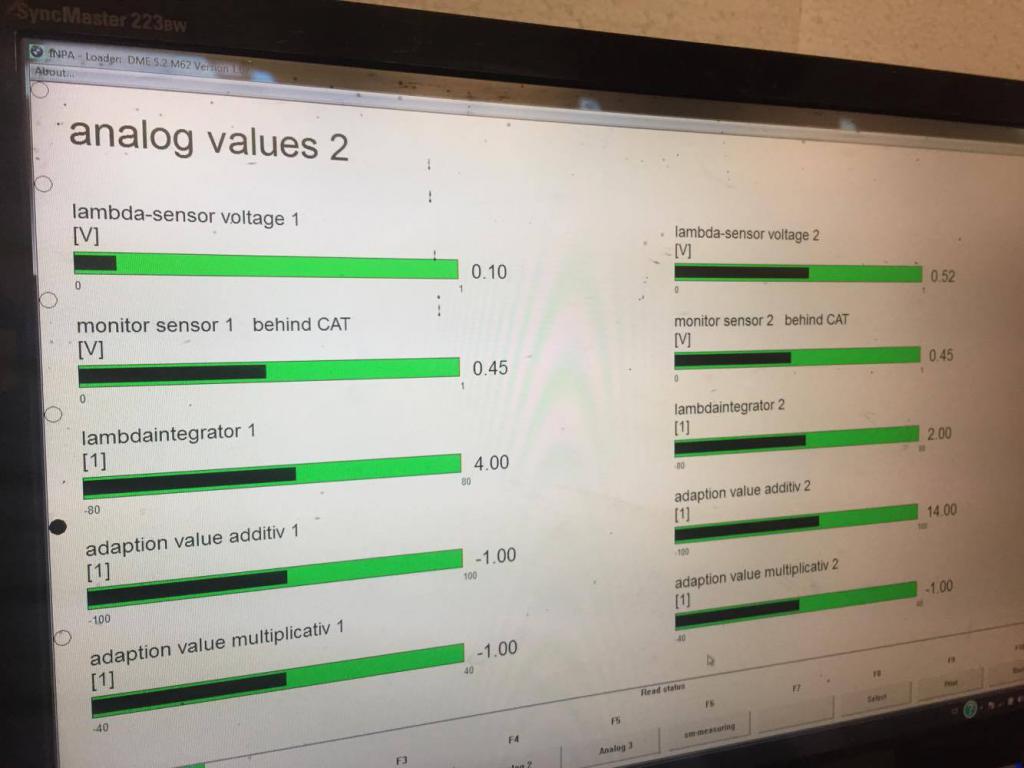

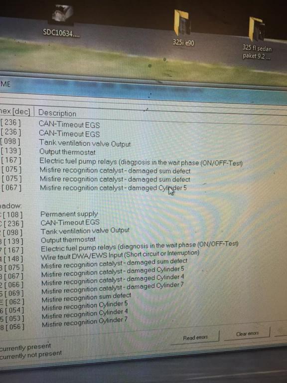

    I have E36 with swaped M62 non vanos using m54 330i tranny with gearbox adapter, CPS sensor is relocated to the front on M60 cover with M60 pulley using M62 CPS , car works , start , no misfire on idlle , no problem with the rpms when car is stay , on 1 and 2 gear no problem with power , rev limiter is around 6200 ( i dont have tacho , only see on diagnostic ) on 3 rd to the 4000-4500 rpm have low power , like you towing 1ton , after 4500rpm kick and car go excelent , diagnostic write about misfire recognition catalyst damage sum defect and misfire recognition catalyst damaged cylinder 5,4,7 and misfire recognition sum defect , this errors throw on 3rd gear , on 1-2 or idlle no errors

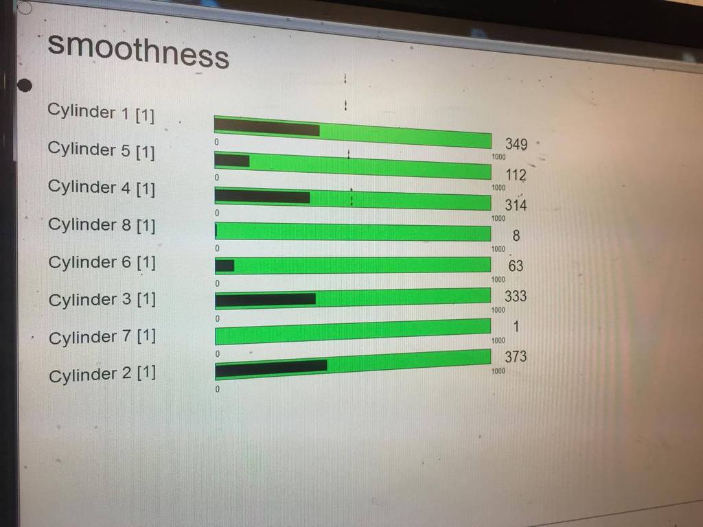

    on inpa smoothnes is on 1 a 2 cylinder over the 1000 , but with these cylinders is not a problem
    complete intake is reseal

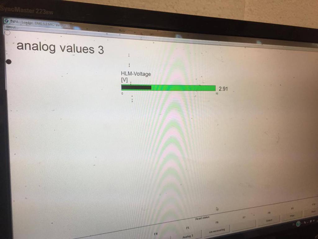

    we try new MAF , CPS is new original BMW, try other coils , new spark plugs NGK , new end of coils , O2 sensors , try other injectors , we chceck timing everything ok , we try compresion test and have 11-12 bar , fuel pump is new bosch e36 325i ( original is car 325i )
    on the last try have 1 more error phase sensor ....
    i dont now what now .... please help thanks
