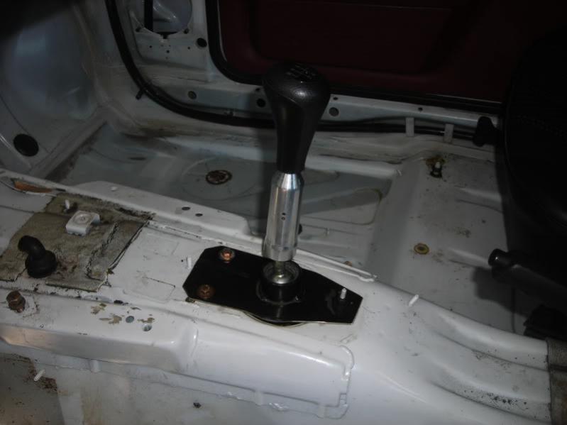

            How about the "poor man" DTM shifter? It's where you take the early model sheet metal console and mount it directly to the trans tunnel, eliminating the need for the carrier. Here's the old write-up I saved that used to be posted somewhere:
            Your car has the mounting points already. It mounts where part of the Automatic shifter mounts, and the rear mounts on the stud that holds the center console. I can't think of any downsides... I mean, this is how some of the DTM cars did it. I was even able to install the selector rod from inside the car, since there's no carrier in the way
            You've gotta have stiff/solid engine and tranny mounts or else the shifter will move around under hard braking/turning/acceleration.
            Buy 1 upper ball cup, 2 lower ball cups and sand one of the two lower cups down in order to fit all 3 in the metal console and lock with the circlip. Cut the upper ball cup with a sharp blade and slip on the shift lever. Replaced all worn out hardware and enjoy !
            Lock Ring 06/1986 23411466112
            BALL CUP LOWER 25111207744
            BALL CUP UPPER 23411466110
            Lock Ring 23411466112
            The picture isn't mine, it used to be floating around the internet, but it gives an idea how it's supposed to work. 36Brua has this setup in his car and it shifts nicely without being difficult for a daily driver.

              I did this install when I went to the V8. Throw away the early shifter/spring, cut up an early metal shift carrier. I just used a cut off wheel and dressed with grinder/file, used parts listed above. I think (?) I have an X5 shifter (taller) in car now. solid condor eng mnts, stk e21 trans mnt w/ AKG cups.
              I did drill new mounting holes bolted it down.
              Set shifter position, measure length of shift rod- joint on trans, cut/weld install.
              Totally eliminates the aluminum carrier. A bit notchy but direct.

                  Yes. Remove console, pull carpet back. You can reuse the rubber shift boot w/ modification to seal between tunnel and carrier

                    Just did this today, no need to remove carpet. Funny, the carpet on my car under the center console seemed like it was already pre-cut in big enough shape to accommodate this mod.
                    I just need to now do some research on what shifter to get, I think something with a longer lower section below the ball would be good since the ball of the shifter is now higher in the transmission tunnel vs stock location.,
                    What are you guys using that work w/o any problems? I've used a z3 shifter before , but not in this configuration.,
