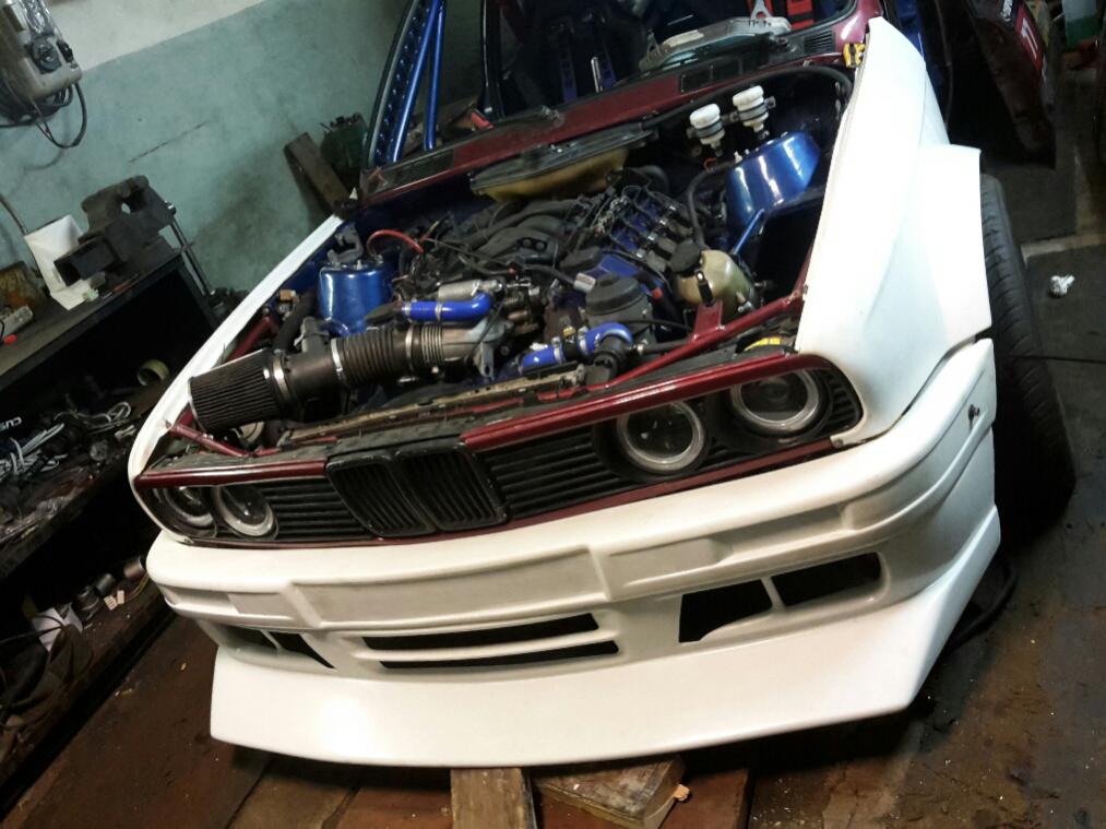

                    By the way here' my drift car i built by myself in 3 years of progress :)

                      Nice! Looks like a tubular front end, were you able to use the e34 radiator with that setup? Any plans to get rid of the ASC throttle body? Doesn't seem like it would clear the hood.
                        Hey, yes its a tubular end, i will currently try to run with e46 rad+eletrical cooling fan. But the bigger rad also fits nicely :)
                        The ASC throttle body inside is deleted. Only kept the elbow for now. I will be replacing it with silicone elbow for cooler look in future :) The hood closes perfectly :)
