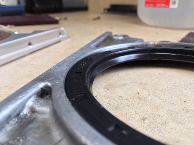

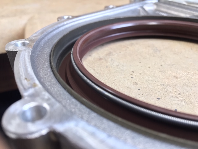

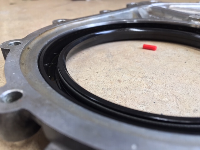

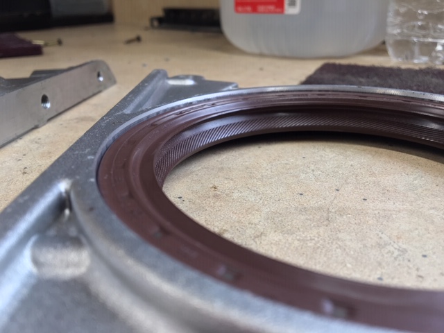

                              I said screw it and yanked the engine. I ordered the new (expensive) rear main seal kit from BMW, with the seal already pressed into a new housing.
                              When I pulled the old seal housing off the block, I noticed the seal was seated crooked. I pushed on it a little bit, and it damn near fell out.
                              Pretty sure you shouldn't be able to do this:
                              The new seal looks quite a bit different. Bare metal outer case, instead of fully coated rubber, and also has an inner and outer sealing lip, instead of just 1, and measured a slightly smaller ID. The old seal was also significantly harder than I expected for 5 years/30k miles.
                              The new housing casting looks a bit cheaper/shittier to me, but I'm not an engineer, it's probably just fine. The sealing surfaces look fine, guess that's all that matters.
