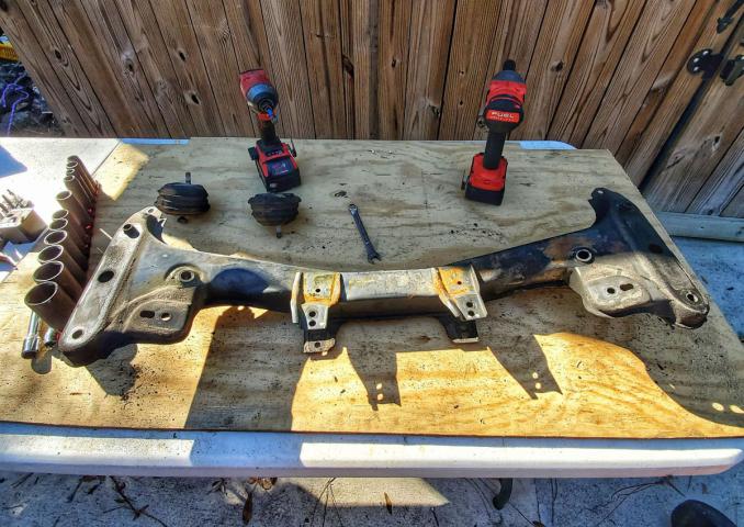

    Got this bad boy out today. Pretty straight forward. Going to degrease, power wash, grind, and hopefully weld up some reinforcements tomorrow.

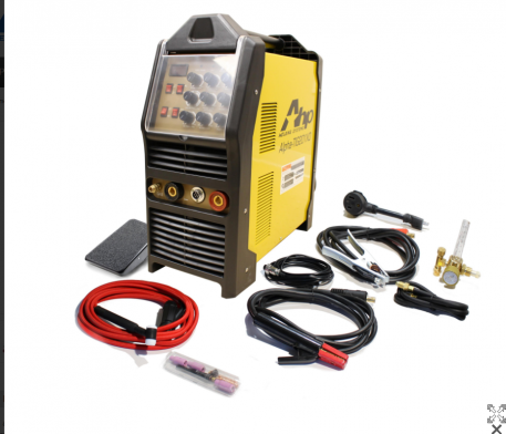

    Anyway -- my parents heard me talking about a tig welder setup I missed out on through facebook marketplace and told me they wanted to give me some cash toward buying one for Christmas.
    Ended up going with the AHP AlphaTig 201XD. Can't wait to get some practice in and figure out how to stack some dimes. Already picked up and assembled a cart and I need to pick up an argon tank.

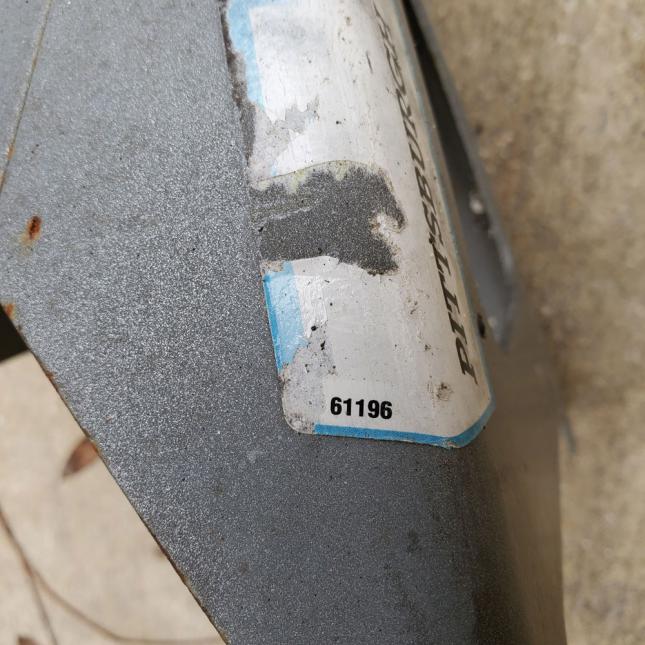

    Finally got the car off of these recalled HF jackstands. I've known about the recall since it was issued, but I wasn't getting under the car since then or I would have replaced them earlier. Told the guy at HF "I brought my death traps in for the death trap recall." I always try to keep a tire/wheel under each side of the car just in case, but god damn is it scary to imagine that these things could have crumpled and killed me.
