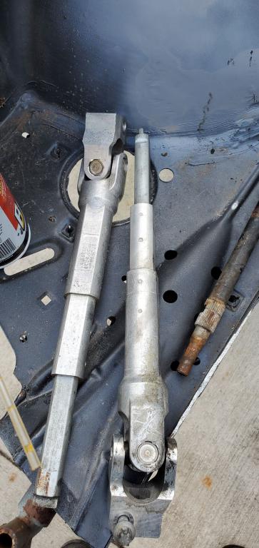

    But now I've got a bit of a road block at the moment with my steering joint plans. I'm using an e46 purple tag rack, and I planned on using these E46 steering shafts that I was going to weld together and make a coupler at a fraction of the price of one of those condor speed shop or sikky shafts.
    What I did not realize is that the non airbag column and the airbag column have a different spline count.
    Airbag splines on left, non airbag splines on right.
    Click image for larger version  Name:	171775014_184136606759061_3055517064274121525_n.jpg Views:	0 Size:	40.4 KB ID:	10002786
    The airbag/coarse splines fit with the e46 joint/coupler I planned on building, and obviously the e46 joint fits up to the e46 rack.
    But now I need to figure out how to adapt the fine splines from the non airbag shaft to fit the joint that will accept coarse splines.
    I could chop off the splines on the non airbag shaft and weld the coarse spline end on I suppose, but I'd like to avoid that.
    Anybody have any solutions -- I'd also like to avoid buying one of those hella expensive Condor Speed Shop joints, but they could probably send me one with mixed splines.

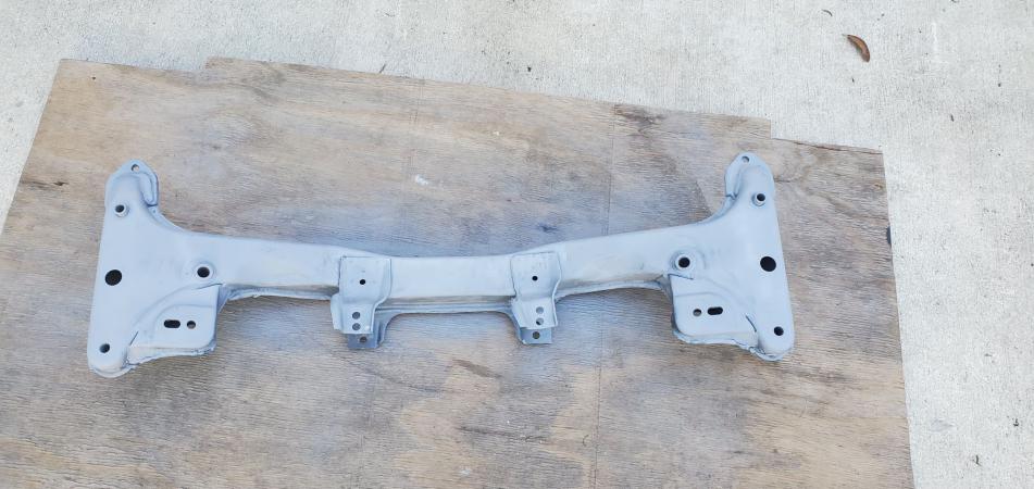

    I ground down the welds on the front subframe, and stripped the whole thing as best as possible with an abrasive pad on my grinder, then primed/painted with VHT Filler Primer/Chassis/Roll Bar Paint.
    Click image for larger version  Name:	1.jpg Views:	0 Size:	77.6 KB ID:	10000794
    Click image for larger version  Name:	2.jpg Views:	0 Size:	66.1 KB ID:	10000795
    Click image for larger version  Name:	3.jpg Views:	0 Size:	72.8 KB ID:	10000796
    Then I installed her with a pair of jacks since I didn't have anyone around to help. This is literally the first thing I've re-assembled since I started work on the car lol.

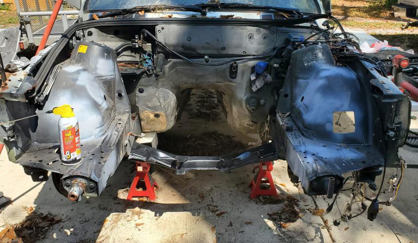

    I ground off some random mounting points that were sticking out around the engine bay from the old components -- I kind of ground a bit too much off of that spot on the right
    where you see a square cut-out..so now that's a brake duct vent. Primed all the spots that were down to bare metal.
    Click image for larger version  Name:	173621208_145044424150519_2200102170676022938_n.jpg Views:	0 Size:	77.1 KB ID:	10000798

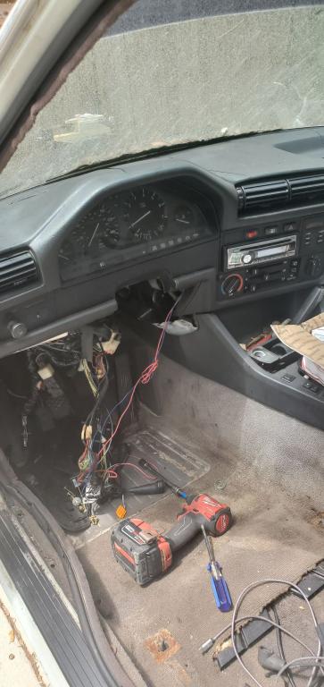

    Pulled the old seats and hit the carpet with a shop vac. It's eventually going to get a steam cleaning and black dye job, probably once I pull it out to do some sound deadening.
    #4DoorGang
    I've gotta swap the steering column out for the non airbag setup, so this is going to be a lot more pleasant to work inside of without the seats in my way.
    Will also be nice for wiring and other such things. The seats were trashed anyway, and it's getting some sort of racing seat set with 5-points. Haven't decided what I'm going with yet.
