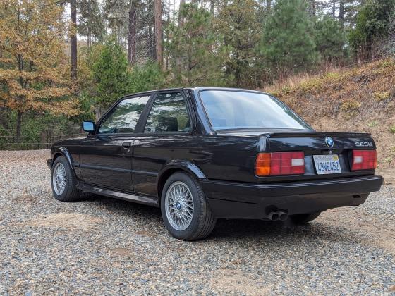

                I did have an IX for quite some time. I did a full interior/exterior restoration on it, got bored, sold it, and immediately regretted it. I bought a Focus RS and had fun with that for a year, and now I'm back to my junkbox E30's. Luckily I got back into them right when the prices went through the roof, so naturally I'll probably never finish this project on cost alone.
